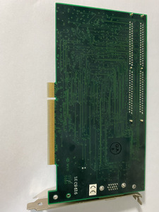

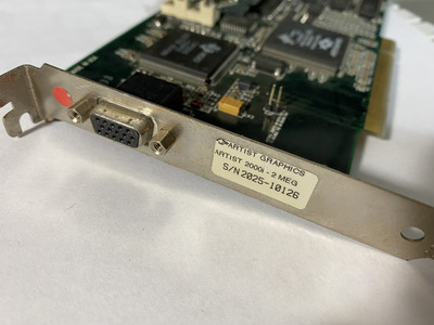

So.... I got a cool 25lb box of random ISA/PCI cards from the 80s-90s from someone in Georgia who was getting rid of them all.

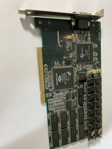

In there was a plethora of cool stuff but one that stuck out for me was the Artist Graphics 2000i PCI.
Never seen a card with 72pin ram modules before.

So, it's come time to start playing with this sucker.
I tried 3 different early socket 5/7 setups but I kept having issues.
Finally got a period-accurate Compaq Deskpro 2000 (Vetz would be proud eh?) w/Pentium 120, 64mb ram and a 512mb CompactFlash going.
Got a fresh load of W95 installed and got the drivers loaded.

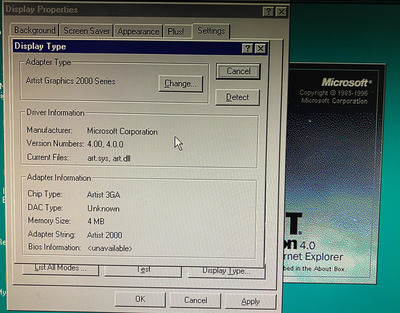

One driver listed on Vogons blue-screened the machine... It's listed as:
Artist Graphics 2000i Display Drivers & Utilities for Windows™ v1.23 -- But this is clearly the Windows 3.11 driver.
Ironically it does appear to load fine until you switch resolutions and then the OS hangs/Bluescreen.

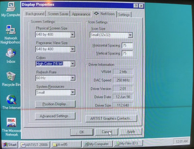

The Windows 95 Driver on Vogons doesn't actually contain an INF the card recognized and I tried the manual load methods.
I was able to use the NetVision driver for W95 and it worked beautifully!

Many basic cards don't come with much for settings - some none other than what W9x offers you natively.

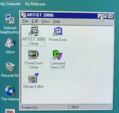

This one has it's own branded tab in Display settings. It has greyscale adjustments, the full company info, VRAM recognized, mild overclocking and more.
It also came with some utilities but they mostly just zoom and magnify things.

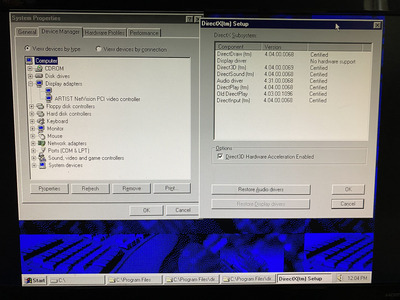

I've been testing it's function in the natively supported acceleration types and I gotta say FOR THE PERIOD -- it's pretty impressive.
Given the fact that the chip itself was originally devised/tested in 1992 (as mentioned in PC World 1992) if they had gotten it to market early enough not much would have competed with it! Sadly since it took till 95-96 by then we were seeing the NV1, Voodoo, and others.

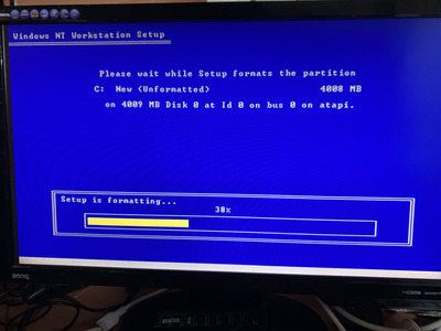

I did a follow up video showing the use of the card but it's been pointed out that it likely didn't fully 3D accelerate. I've read thru the code of all the drivers I could find (4 versions of them) and only the NT drivers mention some acceleration direct to hardware that I could tell. That's here: https://www.youtube.com/watch?v=xONCBNipb8k
