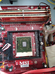

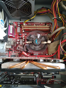

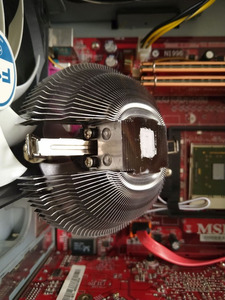

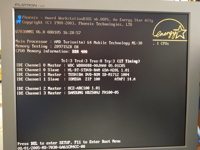

If You want use the Turion CPU on desktop, You need only MT (25W TDP) or ML (35W) series, which are intended for s.754 and mobo with support for them in BIOS (I know that support has MSI boards, but there are other brands too). If You dont know, that Your mobo support Turion, safe bet will be Athlon64/Sempron(64) CPU.
Turion CPU lacks hetspreader, so You need another than stock cooler (or mod them - frame around the socket prevents touching the core) - cheap Zalman CNPS80G will do. Turion has more L2 memory (512/1024kB), than Sempron(64) (128/256) - Athlon64 has mostly 512kB, but some Clawhammers have 1024kB.
The best source of information can be found here: https://silentpcreview.com/amd-turion-64-on-the-desktop/
Mine ML-30 You can see on the photos below.

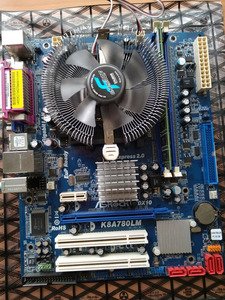

Reply 25 of 28, by Ydee
Another confirmed working board with Turions is ASRock K8A780LM (curiosity with s.754 from 2003!, combined with AMD 760G&710SB from 2009 and designed mainly for AM2/AM2+), but PCIe and lack of drivers for W98 make it unusable for W98 and for XP rig You can find lots of better solutions.
