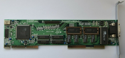

What is the best DRAM to add to this VLB video Card ?
I purchased it on eBay and did not realize it did not have the original DRAM or some just add the wrong type of DRAM.
It appears to be working fine right now and recognizes 2mb
But it still bothers me. I want the right type of DRAM in this card.
So what speed and type of DRAM do you think is best for this video card ?
Its a Cirrus Login 5429 VLB video card with 1mb on board.
Here is the Data sheet on it.

what makes you think that someone soldered on the wrong ram. The card looks the same as one on vga museum. http://www.vgamuseum.info/index.php/cpu/item/ … logic-cl-gd5429
Surely thats not a coincidence.
Reply 2 of 9, by Caluser2000
Looks like the correct ram to me and it , according to you OP, is functioning as it should.
You've done similar posts like this in the past. Whiy?

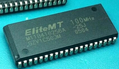

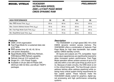

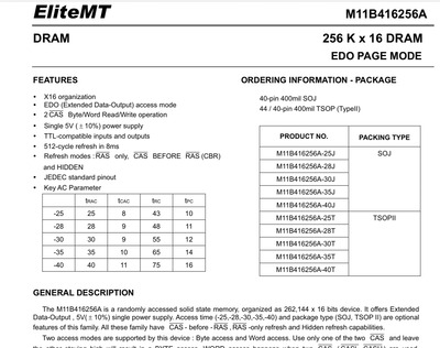

Okay, I found this info on the current EDO DRAM installed.
It reads that the access time is from -25ns to -40ns so I think it should be okay for this video card.
http://pdf.datasheetcatalog.com/datasheets2/38/384008_1.pdf

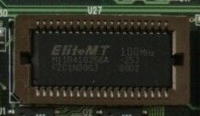

Reply 4 of 9, by cyclone3d
Yeah, it's fine. The soldered on looks like 45ns and the socketed is 25ns so no problem there.

Reply 5 of 9, by dionb
When it comes to latency, lower is better. 25ns is faster than 45ns. It's not listed on the VGA data sheet because those speeds didn't exist when the chip was released.Someone upgraded this card with much newer SOJs.

Reply 8 of 9, by dionb
Intel486dx33 wrote on 2021-06-13, 14:11:
Yes, that is why I was skeptical about the additional DRAM chips used on this card. But it turns out it is okay for this card but most likely will not work on all video cards. I would try to match the soldered on DRAM chips for compatibility.
Once again, lower = better.
"45" means the chips can take it if they get consecutive accesses 45ns apart. "25" means the chips can take it if they get consecutive accesses 25ns apart. 25 can take everything designed for 45ns and then some. The other way round would not work, putting 45ns chips in an application requiring 25ns.
