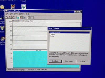

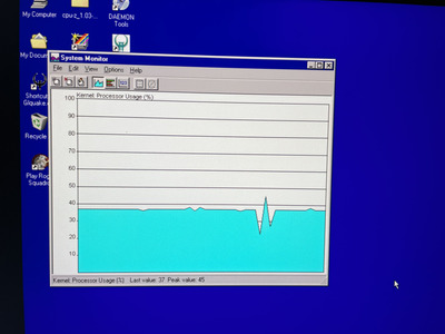

I don’t appear to have anything running. How can I track this down?
System Specs:
1.4Ghz P3
512MB SDRAM
Windows 98 SE
Reply 1 of 4, by DosFreak
Try Sysinternals Process Explorer v8.52

Reply 3 of 4, by Jo22
I could be wrong, but I believe the DOS-based Windows versions don't use HLT instruction.
To make them IDLE, they need ACPI or APM BIOS support. Or a third-party utility (Raine?, amnhltm, wqghlt).
Personally, I used amnhltm.vxd successfully in my 9x VMs.
Without it, the CPU usage was so unacceptable high that it affected my host system.
Anyway, these are just my two cents. 😅
On a real machine, it likely doesn't matter. Or worse, could make games run jerky.
Edit: I have no such late Windows 98 era machines for testing at hand right now.
They are all.. outsourced already, to the landfills. 😉
