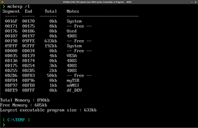

I just looked on my dosbox, my 475 size com uses 0kb, its using 0x12 paragraphs, so just over 256 bytes..
35.66 KiB
966 views
ok I realised what your seeing, the line 136 should be
mov dx,setup_isr ;; already aligned correctly for tsr
shr dx,1
shr dx,1
shr dx,1
shr dx,1
I checked my original, yeah copy pasta error from hacking my uansi driver up for you. if you have umb its fine 😀

I added the missing lines, it works as expected now.
shr dx,1
shr dx,1
shr dx,1
shr dx,1

nah I'm not worry, call it PD 😀 use it as you will, its all cool.
just make sure you get the little patch I put above for fixing the memory
