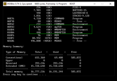

yes. I threw the indos/crit check into my tsr scaffold I wrote. This forceable puts the tsr into umb out of the way if it exists (no need to loadhi/lh it) and will hook + detach.
this is nasm code, as an example hooks int 0x11 but does nothing. you can use this if you want to shove somehthing into umb memory as tsr. its straight out of my ansi driver.

Reply 31 of 47, by Peter Swinkels
I added a check for the critical error and InDOS flags. How does this look: https://github.com/PeterSwinkels/Memory-Dumpi … DOS/upload/main ?

Reply 34 of 47, by Peter Swinkels
Okay, I see your code is a lot more advanced than I had expected. Here's a list of interrupts you appear to be using which I never used:
int 21,48 - allocate memory
int 21,49 - free allocated memory
int 21,4a - modify allocated memory block (setlblock)
int 21,9 - I see your tsr communicates with the user. 😀
int 21,30 - MS-DOS version.

11.88 KiB
1162 views
I see your 475 byte tsr scaffold (myTSR) is using over 4 kb - is it supposed to be using that much? Also, I haven't (yet?) added any memory management to my mmdmptsr.com program, but according to MS-DOS it's not taking up all memory as you can see in the screenshot. And yes, this is actual MS-DOS 6.22 running DOSBox.
13.42 KiB
1162 views
As you can see, the memory management function (int 0x21, ah=0x49) should only be used in combination with (ah=0x48) according to HelpPC, but I don't see a call to that particular function in your TSR anywhere.
Do not read if you don't like attention seeking self-advertisements!
Did you read it anyway? Well, you can find all sorts of stuff I made using various programming languages over here:
https://github.com/peterswinkels
Reply 38 of 47, by BloodyCactus
well my tsr code is very refined. I dont know what you did but it shouldnt be running like 4kb etc. as for your program not taking up all memory.. thats because youve gone tsr. when its loads it has everything, when you call terminate + stay resident it resizes. you can call 0x49 on any valid memory block in the system, that includes the environment block.
Reply 39 of 47, by Peter Swinkels
I did not modify your code in any way. I just assembled it using Nasm. Okay, I will look into 0x49 when I have the time.
