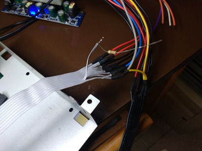

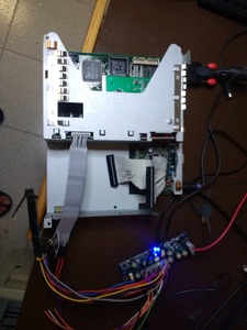

Reply 44 of 72, by dataino.it
My PCS-11 has started, the ATX power supply connection circuit (or pico PSU in may case ) is correct except for the brown wire which is the reset that comes from the original power supply, inserting the test board in fact without that wire connected the resetis off , insert a resistance in series (330 ohm) and a switch to ground the pc turns on by pressing the button, now Igo to insert a reset generator (nee555) to make the computer turn on when the power supply is turned on and a push button for the real reset.

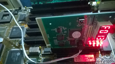

I use a POST CARD (see photo), but there are various models, the cost varies from a little (€) to higher figures, even if it is quite similar (or the same, there are professional ones but they cost a lot), the one that I bought it years ago it is very cheap.
It is mainly used to display the Bios error codes, if for a reason the card does not start, no code is displayed.
So if the PC does not start you do almost nothing, if instead it starts up and freezes, you can see from the codes what could create the problem, it also has LEDs from where you can see if the circuits of the various voltages are ok.

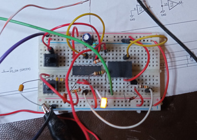

Reply 55 of 72, by dataino.it
I finished testing the circuit and this is the schematic. I would say it works without problems. tomorrow if the heat permits I will do the version on a base (welding with 34 degrees centigrade is torture).
I was wrong to mark the two pins on the previous connection diagram and I corrected it in any case I republish it.

no no problem the card worked and i knew it, because i had repaired the original power supply, but the repair did not hold after a couple of days it died again and definitely. This was my backup plan to be able to ignite it. You have saved me a lot of time with your analysis
