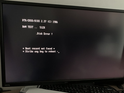

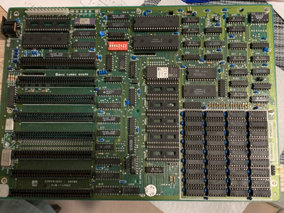

I found this 8088 PC that was stored for a few decades on a shelf of a wooden cabin (out from direct rain and sun exposure, but cold outdoors storage with no insulation, so rain humidity would get in)
Looking at the board, it has the following markings:
8MHz Turbo Board
Pim-Turbo
Copyright 39784
Rev-5
ERSO/ 1984
I put in a known good 8-bit VGA card, AT keyboard, a PC speaker, IO FDC connector, and booted using a known good AT PSU.
Following the jumpering information at https://jamiestarling.com/project-8088-dtk-pi … 8088-2-jumpers/ , which seems to match this board, I jumpered
- use Color 80x25 board,
- use one attached 5 1/4 drive,
- use 128KB of RAM in bank 0 (to minimize the chances of faulty RAM, though this does not seem like that)
Tried attaching four different floppy drives (two 3.5", two 5 1/4", verified working)
The system boots about 75% of the time, and shows the VGA card BIOS line in 80x25 mode. Upon boot, BIOS line shows
DTK/ERSO/BIOS 2.37 (C) 1986
Just before showing the VGA card line, PC speaker produces six beeps:
long - short - long - short - long - short
Then it does a RAM check, which shows all OK. I have not been able to find what that beep means.
Then, about 90% of that time it boots, it prints ".Disk Error". Sometimes rarely it does not give that error at all. It never tries to boot from the disk. Sometimes the motor of the disk drive does come on, but even if a disk is inserted, it won't boot.
Then there is a text "Boot record not found. Strike any key to reboot" (as shown in IMG_1763.jpg), but pressing a key does not help, the system is not reacting to the keyboard. After a few seconds, the text on the screen will always become corrupt in the same way, as show in the screenshot IMG_1765.jpg. (some of the text chars vanish, and individual scanlines disappear from the rest of the glyphs)
About 25% of the time, the system does not boot at all even, but gives a black screen, no beeps.
I've cleaned the board with IPA, there was some mild green battery acid style corrosion in the middle of the board next to the ISA slots, from an external card with battery having leaked on top of the board. But after cleaning it all looks moderately clean, does not look like there would be damage to the traces (that I could tell with a brief multimeter continuity testing, though my electronics abilities are not that great).
Tried setting the boards to different ISA slots, but the behavior seems to be the same on each of them.
The caps look good from outside appearance. Tried to measure the capacitance with a multimeter, though I suppose it may not possible when the caps are connected on the board? (I was not getting any reliable/reproducible readings)
Voltages via the test pads next to the PSU are good (which is to be expected, since the PSU is good)
So not sure what to try next. Any thoughts on how one should approach to diagnosing a board like this? I feel like I don't know where to start - I have very little experience with fixing electronics at this level, this might be beyond my abilities. 🙁 Thanks for any guidance!

Reply 4 of 25, by mkarcher
clb wrote on 2021-07-19, 14:15:
I put in a known good 8-bit VGA card, AT keyboard, a PC speaker, IO FDC connector, and booted using a known good AT PSU. […]
It's not the cause of your issue, but you are not supposed to jumper "Color 80x25" unless you use an actual CGA card. The mainboard BIOS has an integrated CGA and MDA video BIOS. The DIP switches are supposed to mean:
  • Color 40x25: Use integrated CGA BIOS, boot in 40x25 mode (mode 1)
  • Color 80x25: Use integrated CGA BIOS, boot in 80x25 mode (mode 3)
  • Mono 80x25: Use integrated MDA BIOS, boot in 80x25 mode (mode 7)
  • EGA/PGA/VGA: Do not use the integrated video BIOS, use BIOS from a separate video card instead
Most mainboard BIOSes auto-probe for the presence of the selected video card (for CGA and MDA settings), and if you do not have that card, but you do have the other card, they disobey the switches and force Color 80x25 or Mono 80x25. Also, most mainboards initialize the video BIOS (at C000) even if you don't configure "EGA/PGA/VGA", and the video BIOSes make the system work regardless of the switches. It's better to follow documented rules, though, especially if using EGA cards.
If you have both an MDA and a CGA card installed, the DIP switches select which video card is used at boot. If you combine the EGA with a secondary video card (either EGA / mono monitor + CGA card or EGA / color monitor + MDA card), you are supposed to set the mainboard switches to EGA all the time, no matter what card you want to be the primary or secondary video card. Instead, you select the primary video card using the DIP switches on the EGA card instead. The EGA BIOS handles the activation of the mainboard CGA BIOS or mainboard MDA BIOS at boot if the EGA card is secondary or on demand if a program selects a mode that is provided by the non-EGA card.

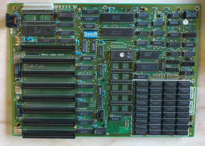

Reply 5 of 25, by Errius
I have one of these boards. I believe this is the manual: http://www.minuszerodegrees.net/manuals/Turbo … ion%20Guide.pdf
ETA: Added picture of my board

Reply 8 of 25, by mkarcher
clb wrote on 2021-07-19, 18:34:
Thanks! I rejumpered switches 5 and 6 to ON state ("Type of Display - None" according to http://www.minuszerodegrees.net/manuals/Turbo … ion%20Guide.pdf. That works, still get the VGA image, and the "long - short - long - short - long - short" beep POST code is now gone! So looks like that was the cause of that BIOS POST beep.
So I was partly wrong about "It's not the cause of your issue". And your reply reminded me that I have a DTK BIOS disassembled at hand. Indeed, 3x (long-short) is expected for "video card/configuration error". The DTK BIOS performs some basic tests of the CGA card that is supposed to be present before it calls the VGA card BIOS to initialize the VGA card. Obviously, your VGA card needs some basic initialization before it behaves similar enough to a CGA card so that it would pass the CGA POST. This is nothing wrong about your VGA card - it is perfectly valid for VGA cards to not respond properly to CGA or MDA like bus cycles until initialized.
If you configure "Type of Display - None", the complete video intialization/self-test section of the mainboard BIOS is skipped, and the BIOS goes straight on to call the VGA BIOS to initialize the VGA card.
