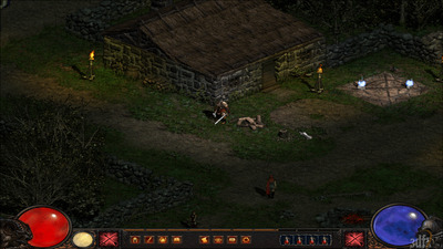

Reply 53 of 237, by Deffnator
Went to test Diablo 2 again using Glide, it still has screen issues with both normal and NAPALM
also Bilinear is fubar and full of artifacts like D3D with anisotropic, which is still another issue.
it should be more like this
https://www.youtube.com/watch?v=bKeUHQ7jl2o
Reply 54 of 237, by Dege
I hate when too much code changes. I found and fixed a bug that's been present from WIP80 (Splinter Cell 3). It affects only D3D9 with the D3D12 backend and I don't want to release a new WIP just because of this. I replaced D3D9 in WIP82 and reuploaded the zips.
Download it again if interested.

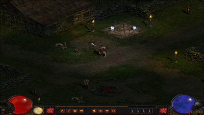

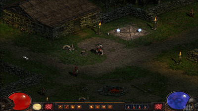

Reply 56 of 237, by Deffnator
Here is Diablo 2 with filters on
Direct 3d
657.81 KiB
1940 views
DDRAW
692.53 KiB
1940 views
3dfx Glide, both Napalm and Normal
679.52 KiB
1940 views
Same artifact issues, even with Median XL which brings the game to 1024x768
Reply 57 of 237, by Dege
lowenz wrote on 2021-10-11, 20:12:
Same black screen 😐
Audio is working.
That bug was about 3D rendering, just look at Sam's dress how it's rendered.
The game itself however works fine for me on my Intel UHD 530 + D3D12 (1280x1024). The driver version is 27.20.100.9466, from 2021.03.30.
