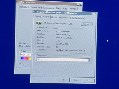

The Win Pro Turbo still eludes me but I did manage to pick this guy up. He’s getting 17.8fps vs the ARK1000’s 18.2 in Phil’s Quake bench, on my setup with AM5x86@160MHz. With all these chips you’d think this thing was 4MB but nope, just 2MB. Any idea what the jumpers do, maybe the memory could be upgraded?

It appears to run 1152x864 in High Color 16-bit mode but the refresh maxes out at 60Hz. I took a guess at the correct Windows 98 driver being (ATIM64 -CT) assuming CT stands for thr Chrontel DAC on this card. If I select anything higher I lose sync. A bit of a shame as it remains crisp at that resolution and 70Hz refresh at 256 colors.

the only jumpers I see are labeled IRQ 2 3 5 , so seems clear, since 2 => 9 vga irq blub
nice card anyway. 😀

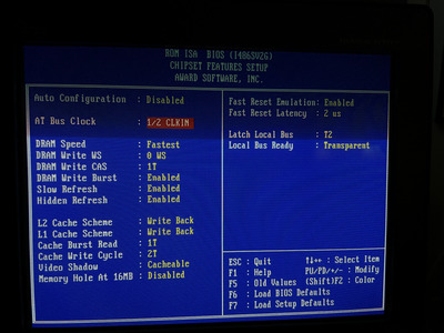

@pshipkov Was finally able to duplicate your results in Quake on the same hardware, the difference seems to be the version of DOS I was using, turns out that 6.22 is quicker, thanks for sending those images over!
And in this instance, AT Bus Clock set to 1/2 seems to land the 27.3 score more consistently, opposed to 1/3.

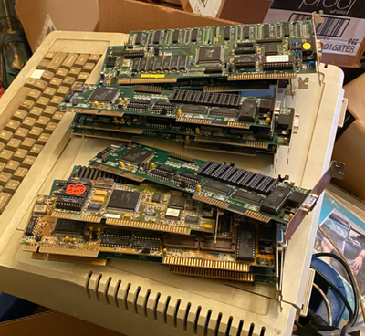

got a bunch more new VLB cards to sift through. there's an ARK and a ET4000W32 in there anyway. the tseng cards are getting ridiculously rare to find.

Nice haul! Let us know if any stand out.

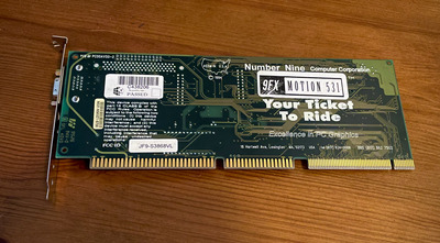

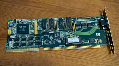

Latest VLB get! Love the looks of this one, especially the trace path leading to the VGA out, and maybe my first Number Nine card. Ticket To Ride! Lol.
Does 16-bit color max out at 1024x768 on this chipset?

Yes, if the card has 2MB RAM installed.
The chip installed on that Number Nine card is the S3 Vision868, the predecessor of the more popular Trio64 family.
Reply 237 of 266, by PC-Engineer
The Vision868 should have the same speed in general like the Vision864 (at same clocks). The Vision868 has an added partial video acceleration (color space conversion and Video scaling and filtering). The Trio64 is a higher clocked Vision864 with included 135MHz DAC, the Trio64V+ is a higher clocked Vision868 with included 135MHz DAC.
But the scaling performance of the Vision868 ist very limited because of the DRAM speed limitations. So the VRAM Variant (Vision968) has a much faster video acceleration.
Your #9 Motion 531 is a nice and rare card, congratulations! The Vision868 variants of the VLB cards are very rare at all.

Just now getting back around to testing the Number Nine 531. For now it simply refuses to boot past the memory test, hanging just before the Promise controller does its thing. I tried setting all the delays on the mobo along with switching between transparent and synchronize modes. Was simply trying to swap cards in my cases machine, I’ll have to test on another VLB board on the bench.
