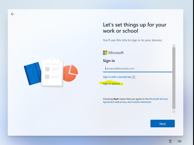

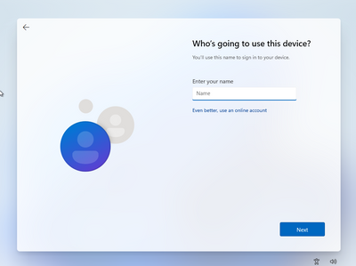

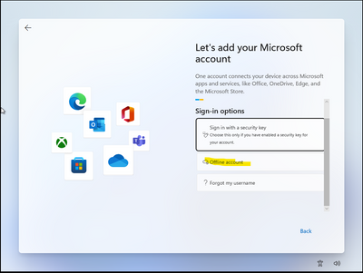

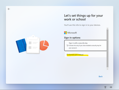

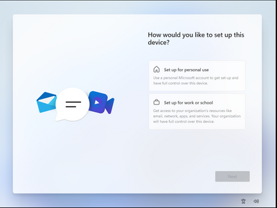

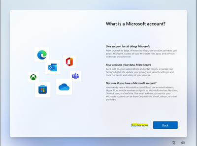

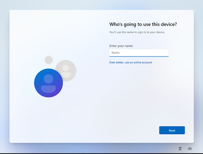

The following is from Windows 11 Pro 21H2, not an insider build. Network connection was plugged in and internet was working at the time.
The options for creating a LOCAL account are right there for all to see. Someone with an Insider build that supposedly removes the option should post pictures or we can sit here and continue having a panic attack based off of websites designed to create clicks and people falling for it.
The pictures are not altered except for usage of a highlighter and anyone can replicate the pictures themselves by installing Windows 11 and clicking through the setup screen so no conspiracy theories please, pictures are legit.
WINDOWS 11 HOME (no pictures provided since they are basically the same as below)
For Windows 11 Home when you get to the screen where it asks to setup your account you'll still need to:
1. Pull the cable
or
2.netsh interface show interface
netsh interface set interface name="INTERFACE NAME" admin=DISABLED
3. Click the back arrow.
4. Create your local account
/EDIT
https://blogs.windows.com/windows-insider/202 … ew-build-22557/
Similar to Windows 11 Home edition, Windows 11 Pro edition now requires internet connectivity during the initial device setup (OOBE) only. If you choose to setup device for personal use, MSA will be required for setup as well. You can expect Microsoft Account to be required in subsequent WIP flights.
Reading the release notes it looks like the "as well" seems to be in reference to Windows 11 Home so "work" should be unaffected in Insider builds but someone would need to verify.
