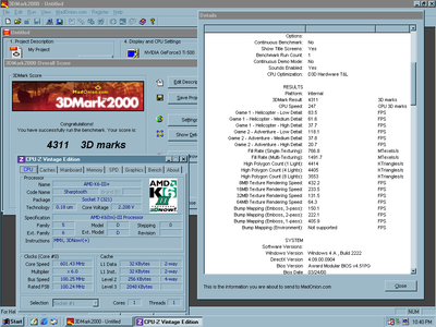

First run with the Ti 500 at stock. This is on my non ultra Freeway.
    81.74 KiB
    1402 views
Reply 61 of 177, by Sphere478
supercordo wrote on 2022-01-27, 03:49:
freakin sweet!
what memory?
using the drivers recommended in the aiming for the stars thread?
using bios settings I posted earlier?
can you look over my overclocking from earlier and let me know if you come up with a different result? it was with the non ultra

Reply 62 of 177, by supercordo
Sphere478 wrote on 2022-01-27, 07:49:
freakin sweet! what memory? […]
freakin sweet!
what memory?
Single stick of 128 at c2. Using your bios settings. Used the 7.76 drivers with the edited ini.

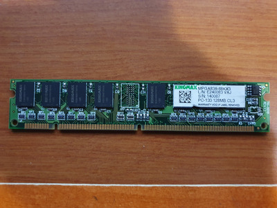

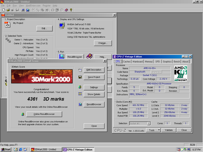

Put 3 sticks of my double sided Kingmax TinyBga PC-133 128 MB CL3 and got 50 more points. They are running at turbo and CL2. The agp drivers that came on the cd for this motherboard seem to be the best.
Reply 66 of 177, by Sphere478
supercordo wrote on 2022-01-27, 23:57:
have you overclocked the ti500?
try windows 95?
that's still like 1000 points shy of the record from the k6 aiming for the stars thread
which is surprising, we may need to start bios tweaking.
I also have some bga ram on the way (pc150) some 256 and some 128 but the max settings are already working with the ram I have, another reason we need some more bios options
and my own ti500 I think the record was with a ti200 (a ti500 should be faster though)
Sphere's PCB projects.

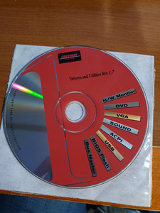

I have not overclocked the Ti500 yet. Been getting my drivers figured out. My issue is i have a 400atz and from what i have been reading they dont like going over 600mhz.

you could upload that driver cd to vogons driver library and link it here 😀

I put in on archive.org
https://archive.org/details/freeway-driver-cd

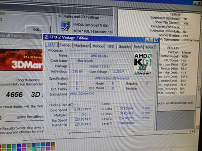

Little Sneak peek. First run on the ultra board. Don't ask for details I'm not done yet.
    900.67 KiB
    1122 views
Reply 74 of 177, by Sphere478
supercordo wrote on 2022-02-03, 01:38:
123 fsb!!! W00t!!
With cache enabled?!?😱
Hey, do me a favor, how’s halo playing on that? :p

Reply 75 of 177, by supercordo
Sphere478 wrote on 2022-02-03, 02:52:
123 fsb!!! W00t!! […]
123 fsb!!! W00t!!
Cache enabled as you can see in CPUz. The Ti 500 is also not overclocked yet.
Reply 76 of 177, by Sphere478
supercordo wrote on 2022-02-03, 02:56:
123 fsb!!! W00t!!
These are good results. But idk if it’s going to be enough to hit the record. 🙁 darn. I was hoping for more. Try win 95
Have you used the k6 tool tools to enable write combining before these runs?
I think the bios you are using now may be a little lacking in k6 + support. I still have not had much luck tracking down a newer bios, our only hope remains the board that I ordered.
Also, try only using the oldest direct x that will run 3dmark 2000

Reply 77 of 177, by supercordo
Sphere478 wrote on 2022-02-03, 04:06:
These are good results. But idk if it’s going to be enough to hit the record. :( darn. I was hoping for more. Try win 95 […]
123 fsb!!! W00t!!
I got windows to load at 133mhz with cache enabled but im having issues getting it stable. Havent used any tweaks yet.
