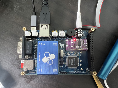

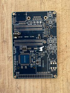

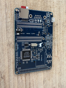

@Eivind thanks for releasing this, this has been an awesome project to undertake, one which me and my sons will get many hours of entertainment from, Awesome job
I have never had PCB’s made, nor soldered quite to this extreme before, it was quite a challenge (not to mention figuring out Kicad to make the led tweak mentioned 😰), I am quite impressed with myself as a novice
Without further ado a few photo’s of my Llama
P.S. for anyone going through the process of ordering PCB’s, one mistake I made is I ordered all the hand soldered parts with the SMD’s… and they don’t send these with the PCB’s, thus I had to order a second set of those components direct 🤣

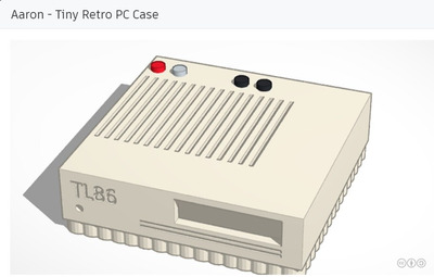

On another note, I ordered a 3D printer during the black Friday deals going on. So once I have my kit in hand I will finalize the details of the case design I started for my TinyLlama. Still need to practice more with the CAD app and watch more tutorials. So far its just a simple empty case with ports. Need to re-do as two halves that can be assembled.

Still looks nice for needing “practice” 😀
