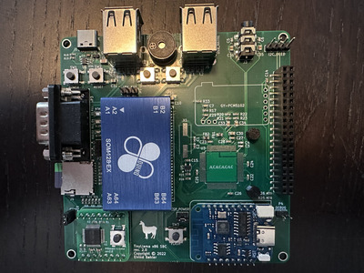

A little update:
I've been playing around with the TinyLlama revision 2.0 prototype board, here are some improvements over 1.1:
* USB-C connector for power
* Momentary switch buttons, including a soft-latch power button
* Better placement of the OLED I2c connector
* Rasteri's HIDman, based on the CH559 chip which translates USB HID devices into proper PS/2 signals. Works much better than having the BIOS do a mediocre job of emulating PS/2. Plus, this frees up the two native USB ports for storage.
* Wemos D1 mini ESP8266 board which can be used as a Hayes-compatible modem, or provide a TCP/IP stack in DOS using either PPP or SLIP
* All components, with the exception of the SOM pins, CS4237B chip + crystal and the D1 mini are assembled by the PCB manufacturer, making it possible for me to sell a few of these fully assembled and ready to go. Of course I'll still keep the design 100% open source for those who want to modify/assemble themselves.
The current prototype measures 100 x 100 mm, I'm currently in the process of redesigning it down to around 100 x 77 mm by ditching the HIDman daughter board and moving the CH559 directly onto the PCB + moving the D1 mini to the bottom side of the board. I'll also try hooking up 4 lines from the CH559 to the joystick input of the CS4237B and see if we can get USB gamepad-to-analog joystick conversion working down the road.
1.49 MiB
1539 views
PS. A little bird from Taiwan told me fall 2023 could be a very exciting time for llama enthusiasts. 😉

Reply 266 of 661, by tabm0de
Eivind wrote on 2022-12-20, 12:07:
A little update: […]
A little update:
Dont know if it’s best idea, but just throwing it out, thinking if you wanted to save some space maybe serial port could be as old boards and just headers, that might save some small space and maybe can be top soldered;)
naa, nothing yet...
Reply 267 of 661, by Eivind
tabm0de wrote on 2022-12-21, 13:13:
I think there's balance to be struck, between compactness and utility. I like having the serial port there, attached to the main board. So that'll stay! 😀
The bottom of the board is already far from flat because of the VGA module, so having the ESP board there as well doesn't really mess with the overall height.
I'll post some 3d mockups when I'm done with the new layout! 👍

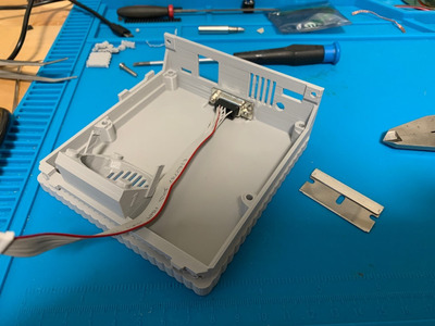

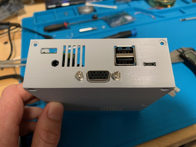

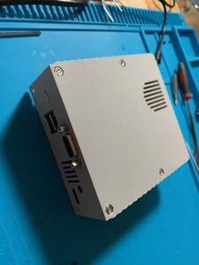

Reply 268 of 661, by Aaron707
I am really liking the updated board! I think I fixed my board as well. I damaged my 3.3v regulator so soldered in new one and it boots now! Printed my case for the 3rd time. Its getting there. Not sure what revision I am on at this point. Will need to lower VGA port 1mm possibly. Its really close to bottom of PCB so I cut the pins near the center rear of the bottom of the PCB and put some kapton tape over the vga connector housing to be safe. Hopefully printing the final version this weekend and get the OS and software all squared away. Then I get to enjoy all the retro fun while looking forward to the next improved version!
One option to get the 2.0 board smaller would be for a daughter board for the switches with a cable connecting them to main pcb. Then you can place the switches anywhere like the front of the case. But that is also something easily done by the end user if desired.

Reply 269 of 661, by Eivind
Aaron707 wrote on 2022-12-23, 02:24:
Glad to hear it! 😀
Looking fantastic! 👍
I like your idea of having "panel buttons" - I'm adding a pin header for that right now! 😀 I think I'll still keep the mounted buttons in place though. While I (also) like putting the board in a shmick case, I don't feel this should be a requirement.
