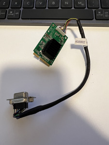

Reply 342 of 661, by tabm0de
The vga cards came today from chamsys.co.uk, will se if i have time to test them tonight.
*edited, tested, ye seems exactly the same as rasteri as the chip is the same 😉
    1.01 MiB
    1655 views
naa, nothing yet...

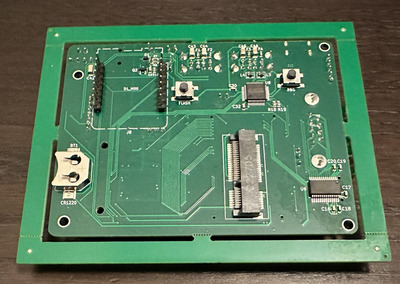

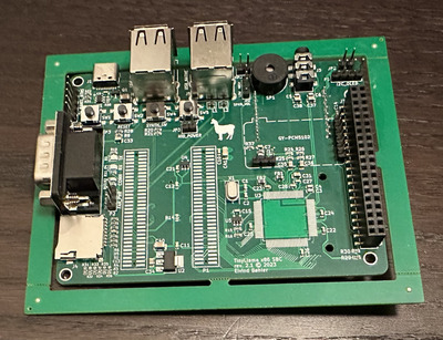

Reply 355 of 661, by Eivind
I finally got to play with the SM750 card, and it was indeed a very nice upgrade from the Vortex86VGA. Can even play Quake2 now, nice. 😎
In other news, my rev2.1 boards were delivered today! Here are a couple of screenshots of one, still in its break-away panel:

Reply 357 of 661, by Eivind
tabm0de wrote on 2023-01-19, 06:11:
Did you play with sm750 on the new board or old on? 😉
The 2.1 version, but there are no changes from 1.1 -> 2.1 that should affect performance or compatibility.
Board looks nice 😀 is it hand made or have you ordered it with the Components ?
The pictures show what I got delivered. I only have to solder the SOM pin headers, crystal chip, DAC board and D1 Mini. I already did the pin headers and got the system up and running. Hopefully I'll be able to do the rest later today and do a thorough round of testing. Looks promising!
