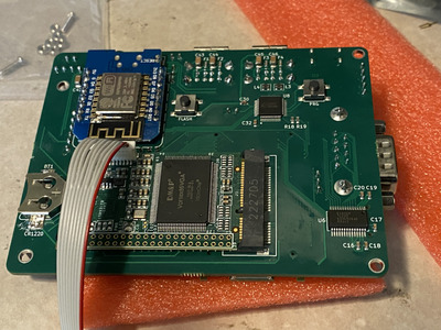

Is it possible to easily connect an ESP8266 wifi module to Rev 1.1 TinyLlama board? The v1.1 has an unused TTL serial port header (COM2) so was just looking to add some modem connectivity if not too difficult. Thanks
Reply 475 of 661, by Eivind
Aaron707 wrote on 2023-03-14, 18:32:
Yeah sure, take a look at the 2.1 schematics, you'll only need to hook up RX2, TX2, GND and VCC (5V). The first 3 from the "TTL_SERIAL" as you said - 5V you can get from the "FAN_PWR" or "I2C_OLED" connector (or solder a wire directly from somewhere else).

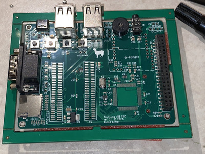

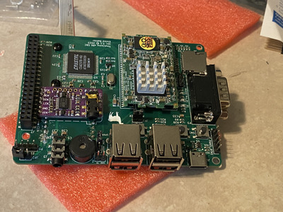

I got my boards back from JLCPCB and got the crystals and audio connectors soldered. Also bought a cursed USB-A to A cable and programmed the HIDMan on all of them. I've attached a picture of one of the boards after adding the crystal and audio jack, and then top/bottom pics of one fully complete. I'll be flashing the BIOS and testing mine this evening.
If you're in the US and interested in one of the semi-complete boards, see my post here. I've got 6 left.

Quick update on a Saturday evening:
I've updated the v2 BIOS to properly handle setting typematic rate/delay ("mode con rate=32 delay=1" 😉).
Also, I got the Dreamblaster S2 that Aaron707 so kindly ordered for me from Serdashop, and Serge also sent me the Dreamblaster X2GS for free! (thanks again, Serge, if you're reading this!) 😁
I hooked it up to the TinyLlama using a few wires, and sweet sound came straight out!
This bodes well for the adapter board, I'll finish it up and put in an order from JLC one of these days.

Eivind wrote on 2023-03-18, 21:52:
Quick update on a Saturday evening: […]
