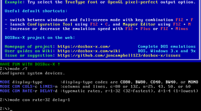

MODE CON: RATE=32 DELAY=1
is there a way to achieve this command in dosbox?

Reply 3 of 7, by _Rob
I don't know what you did wrong, but it works just fine in dosbox-x.
12.17 KiB
1179 views
And you CAN use the mode command from other DOS versions, you just need to set your reported DOS version to match. By default DOSBox pretends to be DOS 5.0, so use "ver set 6 22" to set version 6.22
Lastly, you don't need to download the whole of freedos to just get the mode command. A quick search turned up:
https://www.ibiblio.org/pub/micro/pc-stuff/fr … /dos/mode/2015/

Reply 5 of 7, by dr_st
Create a .COM file with the following 12 bytes and run it in DOSBOX:
B8 05 03 BB 00 00 CD 16 B4 4C CD 21
This is the assembled sequence for:
mov ax, 0305h
mov bx, 0000h
int 16h
mov ah, 4ch
int 21h
Which achieves the same effect of MODE CON RATE=32 DELAY=1 (maximum rate, minimum delay).
