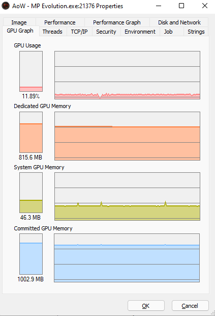

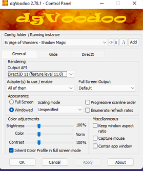

I'm using the latest Dgvoodoo version. But I noticed that the game has low fps (about 25 fps) in 4k (3840x2160) in comparison to lower screen resolutions while not using much of the resources at all. The game could be only run under windowed mode with dgvoodoo. And only in through Direct3d11 (feature level 11). All affinities and process priority is set to maximum. System Windows 10, i5-12600K 3.70 GHz, 16 Gb, Geforce 3070TI.
Is there a way to increase FPS in game ? May be there are some settings in dgvoodoo which are set wrong? Is there a way to run throughg Direct3d12?

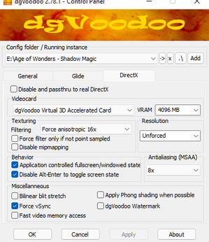

Too lazy to download and check, but options that can have an impact on performance:
* General/Output API (try Direct3D11 and Direct3D12)
* DirectX/Fast video memory access
* DirectXExt*/Batched update for primary surface
And the obvious ones (antialiasing, resolution, fps limit, vsync).

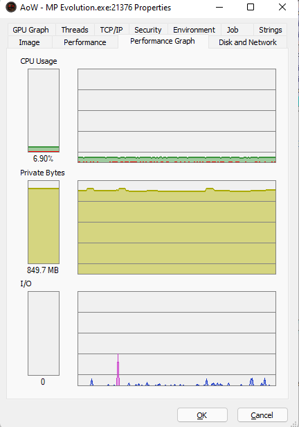

As for CPU - on the screens above I see it's not using it full-power. Also overclocked it a bit - it doesn't have any impact on FPS.
Then I think you're not reading it correctly. Age of Wonders: Shadow Magic was released in 2003, predating multi core processors as such it likely can only use one CPU core at the same time, so for it to be struggling with CPU all it would have to do is max out 1/16 of your processor. 100/16 = 6.25, your screenshot shows 6.90... So yeah. It doesn't necessarily mean that's the problem (some old games just used 100% of thread CPU regardless of what they were doing), but it certainly isn't unlikely.
