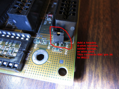

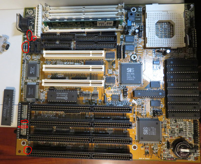

I've had several requests over the years requesting guidance on adding PS/2 mouse support to the MSI MS-4144 motherboard, similar to what had been presented for the Chaintech 486SPM here: Adding PS/2 mouse components to a Chaintech 486SPM
I've attaches some photos and a PDF scan to guide you. There is a typo in the PDF scan. Where you see "R140", it should read "R14". My motherboard revision is 2.1. There may be some differences with other revisions. Please check the photos carfeully.
MS-4144_PS2_Mouse_sketches.pdf
50.41 KiB
83 downloads
In brief:
1) Add two 47 pF surface mount capacitors. The motherboard's silkscreen states 470 pF, however I'm pretty sure I used 47 pF because that is what is normally used on other motherboards and is what I had on hand.
2) Add a 5-pin connector at J5. The pinouts are Vcc, N/C, GND, CLK, DATA.
3) Add two through-hole inductors at L4 and L5. Most 486 era motherboards I've encountered have these in the 1-10 uH range. I normally use 2.2 uH, but I think in this particular board, I am using 1 uH.

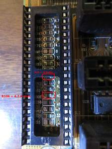

4) Under the keyboard socket, ensure that R14 and R106 are populated. Your motherboard revision might have these components missing. My board had them already installed and were such that R106 = 4.7 K-ohm and R14 = 10 K-ohm.
5) Short R147. This connects KBC pin 36 to IRQ 12. The PS/2 mouse won't work without it. For my board, I used a jumper header and jumper, but it is a bit tricky to implement because the pads are SMD. Thus, you can just solder these pads closed, use a 0-ohm resistor, or solder on a wire.

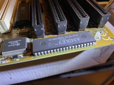

feipoa wrote on 2022-04-18, 23:34:
I take it your board already had R14 and R106 populated?
Unfortunately my KBC isn’t socketed so unsure atm.
I’ll add those parts just in case and a socket.
Reply 5 of 16, by feipoa
Just measure from L4 to 5 V and from L5 to 5 V. Assuming negligible impact from the KBC and inverter IC, if L4 to 5 V measures 4.7-10K and L5 to 5 V measures 4.7-10K, then those resistors should be in place. if you get some weird measurement, let me know and I'll pull my board and measure these values.
It is always a good idea to have DIP-40 sockets on hand anyway.
Reply 6 of 16, by Chadti99
feipoa wrote on 2022-04-19, 00:41:
If I’m doing this correctly L4 is measuring 9.35 and L5 is measuring 4.68.
Reply 9 of 16, by Chadti99
Or not, the capacitors I picked are dust sized 🤣. How do I go about picking the right size?
Reply 10 of 16, by feipoa
Measure the pads and follow the size chart:
https://www.kadvacorp.com/technology/smd-capacitor-sizes/
I bet you could still get those to solder on. If you look at the caps on my board, they are also some of the smaller varieties. They were left-over from another job.
Reply 12 of 16, by feipoa
Click the above photos. What you see shown is a down-scaled size. I uploaded high res photos of all, but you need to click on them.
Reply 13 of 16, by Chadti99
Success!
I had clock and data reversed. It’s basically the same pin-out as the 4DPS so already had a ps2 adapter ready to go but for some reason I thought I needed to swap those two for this board. Toned it out and found out I was wrong 🤣.
Those caps are so small they kept trying to align with the sky when one end heated up, had to hold them down.
Thank you feipoa!
