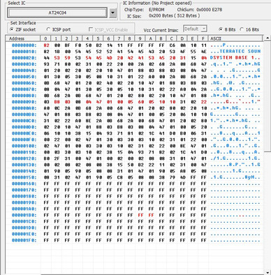

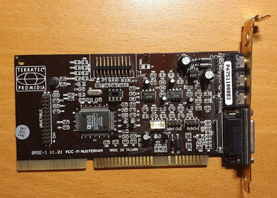

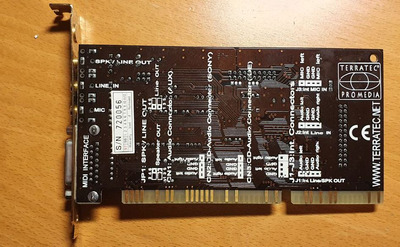

I recently got this Terratec BASE-1 V1.01 that seemed completely dead to the system (trying with Unisound or the drivers Phil luckily provided here: https://www.philscomputerlab.com/terratec-pro … dia-base-1.html):
131.01 KiB
1185 views
146.85 KiB
1185 views
For a first troubleshooting, I have removed the Eeprom (24C04) after which unisound was able to detect the card (albeit without any sound output).
So, it seems, the content has the card in some wrong (or corrupted) init mode and there is some other issue with the Amp-section.
This is what the original drivers report (there's also no sign of the PNP ID it is looking for in the eeprom):
47.55 KiB
1185 views
Before I go into more troubleshooting, I'd like to test the card with a proper eeprom content (so I can be sure it's not just a wrong setting for the audio out).
Would anyone maybe happen to have this card and being able to upload the eeprom content (or verify against the attached .hex file)? Or is there an eeprom tool similar to the one for the Crystal 423x?

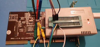

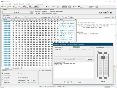

Reply 5 of 13, by MJay99
Btw., I tried and reading it in situ is luckily very much possible:
125.61 KiB
1086 views
257.54 KiB
1086 views
I've verified it against the downloaded content of the directly read eeprom and it's 100% the same.
So, if you could maybe try it that way, it would help immensely!
Reply 6 of 13, by dionb
Don't have the DuPont to clips you are using - but very much want to order them looking at this 😀
- in fact, just did so. AliExpress, so could take a while, but ordered two sets from different sellers to be sure.
Reply 7 of 13, by MJay99
Awesome, thank you, I'm very much looking forward to them arriving! I recall them being quite cheap there, but if you want me to Paypal you some Euros for them, I'll be happy to do that.
Oh, and when you try, you can make your life a little less complicated than I did in that picture and put all the cables on the reader side into a socket first, so you don't have to fiddle them in all at the same time... It did work, but it's supposedly always better to work smart, not hard... 😁

Maybe it is not the card but the card in combination with your specific setup that causes issues. What kind of Mainboard/CPU/ram configuration do you have? I remember having trouble with AD1816ADJ cards as well but I forgot if it was due to driver issues or hardware setup. I have at least two of these cards and maybe can simulate your setup to see if I can help somehow. Of course if it is really a defective card this won't help but as EPROM content was identical It may be another issue.
Anyway, I hope you can rescue the card! It's quite interesting with it's strange FM and the hardware layout with the dual opamp offers quite good and noiseless sound quality.
Reply 10 of 13, by MJay99
Thank you for the offer! I've tried it on 3 different systems - one being a 386SX SBC, another being a 586 with PnP and my regular testing rig (a 486 DX2-66) with DRAM sizes of 8 to 32 MB (mostly 30 pin FPM). I've tried both, the original drivers and unisound and only without the eeprom the card gets detected - so something seems wrong there already. The verify in the above picture was only against itself, not against a known-good content (I was just testing if reading and verifying it on the card would work, so that noone would have to desolder the IC for a dump of its content). I'm still missing this known-good content, just to make sure it's not simply some setting that's deactivating the audio out or configuring it wrong in its default state, without the eeprom.
Without the eeprom the card actually gets initialized by e.g. unisound and recognized by things like MODM and pretends to be playing music. But even checking its output right on the IC with an oscilloscope, it's completely inactive.
Since I got this card from a colleague (where it wasn't showing any signs of life either), I'm pretty sure it's not the hardware (or software) setup around the card, even though I would never rule this out, of course. The only common things would probably be a DOS 6.22 with HIMEM and Unisound.
The card itself came from Ebay before that, so it's pretty impossible to tell what it had to suffer through. I did check everything visually though and it seems to be in very good optical shape (no scratches, dented pins, etc).
As long as I can get the eeprom content, I'm pretty sure it'll be revived - even if it turns out to be the main IC in the end. I've already found a source for a suitable replacement part and have done replacements of similar size ICs on mainboards and soundcards before - so this won't be a show-stopper 😁

You're awesome, thank you very much! The diff I now could do, did indeed show a significant difference that's suggesting a corruption of the eeprom content on this card (especially looking at the card's name in the eeprom):
214.7 KiB
863 views
GPL-2.0-or-later
Sadly, even with this new content, it didn't come alive again (still not getting detected by the original drivers, or unisound on my testing rig).
I'll start checking a couple of caps around the AD1816 next and then it's probably going to be a new main IC, as even without the eeprom, it's not giving out any audio.
Before that, I'll again put this card into a couple of different mainboards, just in case the selective issues you described before might also influence this.
Taking this card out of my testing system, I noticed the AD1816 to be noticably warm - far from being hot, but also not as cool as I'd have expected it to be after a rather short time (that's why I'll be checking caps, just for good measure).
In case your card is still in a system: does the AD1816 get noticeable warm also?
I'm still collecting parts and they'll have to be coming from China, so a change of the AD1816 is going to take a little time, but it will happen 😀

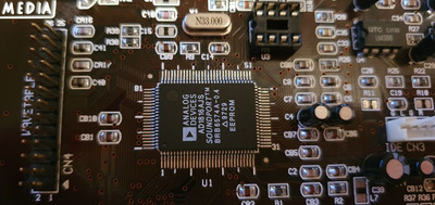

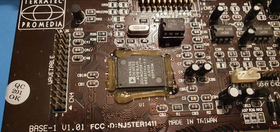

Reply 13 of 13, by MJay99
All checked and no shorts found. And just in a hail mary attempt (even though everything did look ok), a resoldering of the QFP:
214.94 KiB
858 views
GPL-2.0-or-later
155.23 KiB
858 views
GPL-2.0-or-later
The final step is gonna be a removal of the coupling caps to the amp and another view with the oscilloscope right at the line-out pins of the AD1816 (while it's pretending to play without an eeprom) and then it's probably gonna be replacement time, unless there's more and better ideas left 😀
