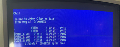

Reply 5 of 10, by epictronics
Thanks, but no luck yet
RAR 3.93 don't seem to run under DOS 3.30. It just produces some weird characters when I try to run it.
I split my file in 3pcs in WinSplit 1.0 and used the /b to merge but got "0 files copied"
I'll try PKzip next, thanks

Reply 6 of 10, by weedeewee
your filenames are PCV10__A.00x in the dirlisting
your filenames are PCV10_A.00x in the copy command
