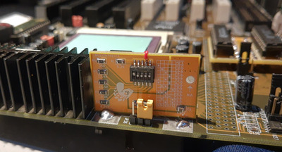

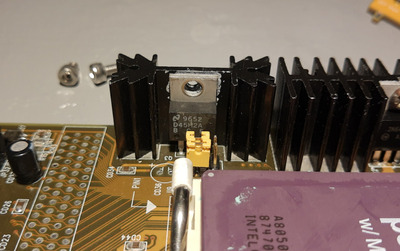

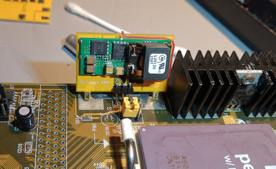

Hello there!
So the installation didn't go great.
The legs of the PCB were too far apart so I cut the legs off and tombstoned the PCB to the pad under the original heatsink.
Other than that, things went smoothly.
I removed a jumper block from the front of the PCB and replaced it with hard jumpers so the CPU vcore is powered from the murata and only the murata now. I added JP36 which changes the input voltage between 5v from the PSU and 3.3v from the CPU io VRM module. Currently it is now set to 5v.
The board does fit decently well and the dip switch is easily available.
Using the Pentium MMX cpu and setting the murata to 2.8V with dip 1, I booted the PC expecting the worst but it posted and booted!
Huzzah, it works.
As a fun test I kept air flow away from the large IO VRM heatsink that would get so hot it was very uncomfortable to touch before and after 20 mins of sitting idle, the heatsink was just slightly warmer than the PC case itself.
So that means less energy being dumped off as heat.
This post is a bit all over the place I know but this is still initial thoughts. I'll probably structure this information in a future post when I try the super socket 7 k6 cpu on the mobo.
Wish me luck!
-Lime.

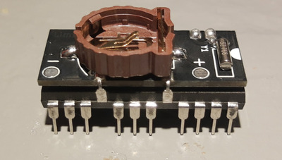

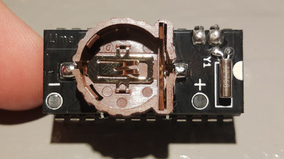

I finally put one of the DS128x hats together.
it came out decent for a quickly thrown together board. Might add a mirrored set of pads on the bottom so the user can solder the dip legs for the battery on the underside of the PCB vs under the battery holder like I did here.

Quick update,
The DS128X hat worked a treat even with a cheap ali express DS12885.
I also did install the AMD k6-2 with the voltage mod and it does work just fine. I did finally order and receive the new revision of the ss7 VRM board thing. It does look nice.
The system clock of 66mhz is a bottle neck but eh, no biggie.
Maybe I should update the board to work similar to what necroware made ages ago. The OKI module really works a treat, I'm not even getting any coil whine.

Reply 227 of 240, by majestyk
I was just looking at the VRMs, was the one with the small heatsink the one that was getting hot? This would be a design flaw since the one with the small heatsink is supposed to be responsible for the 3.3V I/O voltage where there´s only a tiny current and quite little heat dissipation.

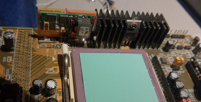

Reply 230 of 240, by CalamityLime
majestyk wrote on 2022-10-15, 15:06:
The large heat sink generated the 3.6 or 3.3 for io and single voltage cpus, the smaller heat sink generated the 2.odd voltage for dual votage cpu's. The small heatsink was feed off of the large one so the large one would get hottest really.
Since installing the OKI module where the small heatsink was, the large heatsink just makes the 3.3 for io and the OKI module generates the 2.2v from 5v for my AMD 2.
Neither get hot. I left the system on for a few hours just running some game benchmarks and getting audio drivers working. I couldn't feel any heat from either the OKI module or the large heatsink.

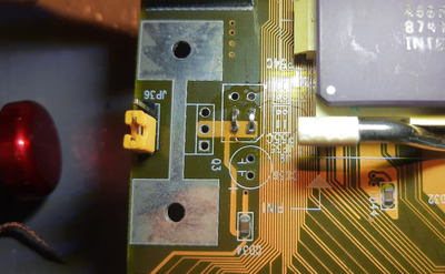

Reply 232 of 240, by majestyk
So they "cascaded" the two regulators. Some manufacturers did that to limit the heat disspation of the second VRM, but the drawback is that the 2nd VRM acts as a variable (instable) load at the output of the 1st VWM. This design is not first choice.
To improve / optimize the situation you can cut the connection between the output of VRM1 and the input of VRM2 and connect the latter directly to the 5V rail.
Reply 233 of 240, by CalamityLime
majestyk wrote on 2022-10-16, 17:52:
yeah, I've done that already. There was a spot behind the small VRM for a pin header to switch between the output for VRM1 and 5v for the input of VRM2

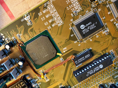

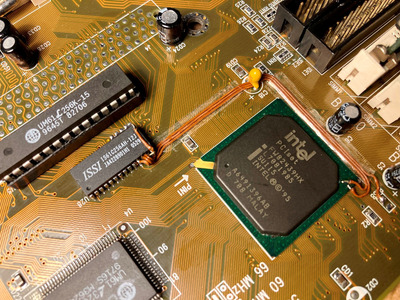

While looking at my own SY-5TF I thought of an alternative approach to integrate the second TAG-RAM chip. Why not use the landings for the TAG-RAM besides the DIL TAG-Socket?
Most connections can be used since they are wired parallel to the first TAG chip.
So I cut the legs of the new TAG chip that mustn´t have contact with the PCB, added 5 x 10K SMD resistors at the unsused I/O ports (7:3), connected the common side to ground, removed the 10K resistor on the mainboard at the TIO10 pin of the MCH that pulls TIO10 up when there´s only 64MB cacheable area provided, added a 10K resistor directly at the new TAG chip between GND and I/O2 / pin13 (=TIO10) to pull the line down, soldered the new chip and made 3 wire connections to the TIO 10:8 pins.
That´s what it looks like:
909.97 KiB
484 views
This works perfectly and is a quick and dirty solution for HX mainboards that have the landings for another chip in the layout that is not intended to extend the existing TAG but for having a second possibility to populate one TAG chip (SOJ instead of DIL or vice versa).
Now the wires must be fixated so they don´t get hurt...

Reply 236 of 240, by majestyk
Yea, if only boards were more standardised so we could make a little "bridge-pcb" for many models.
I fixated the wires in the meantime by using doublesided duct-tape between the wires and pcb and a layer of sellotape on top to cover the sticky surface.
940.33 KiB
463 views
The wires are safe now but I still need some seal for the soldering joints.
The requirement is that all of this is completely reversible if needed.

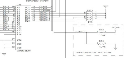

The resistors at the unused I/O lines are suggested as 10K pull-ups in the original Intel circuit diagram for 430HX mainboards, but in 95% of the cases where two TAG-RAMS are populated on mainboards or COAST modules these resistors do not exist.
61.93 KiB
454 views
