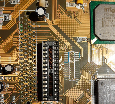

I buzzed out the cache connections on the 5TF some years ago. The two tag positions (DIP and SO) are connected to the same 8 tag bits (T0..T7), and these are also the only tag bits connected to the COAST slot. Looking at the traces emanating from the north bridge, I am very confident that the T8..T10 balls are not routed at all, thus negating one of the main selling points of the 430HX chipset.
Reply 43 of 240, by majestyk
THat´s a pity!
So they just implemented the old COAST standard with pins 6, 86 and 88 = NC, but packed 512K L2 cache on the board just for the PR-gag.
At least on the upper side there are no visible connections to these pins (green). And it slipped my eye that at the SMD pads all 7 I/O lines (green) are used which would be pointless if it was designed to act as additional TAG-RAM.
The SMD pads are only to be used for alternative (SMD) chips.

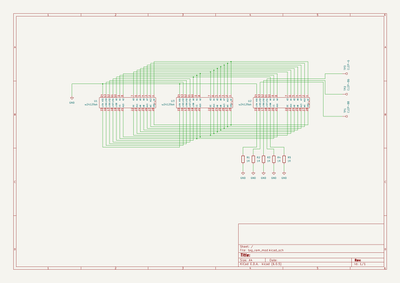

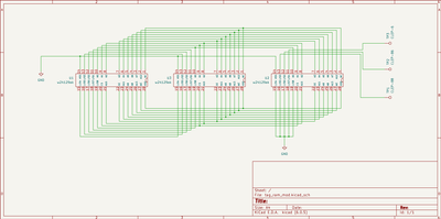

Reply 44 of 240, by CalamityLime
So following the instructions I layed out a circuit.
U1 is the first tag ram chip, U2 is the second tag ram chip and U3 is just the pin header to connect to the motherboard.
The Test points have their value set to the CLEP pin they go to.
Is this right so far?

Note: I did check the highlighted through hole pads 6 86 and 88 and they do not have a trace going to them.
Tis a shame but we could still make up a board and open source it. Maybe someone else would find it useful.

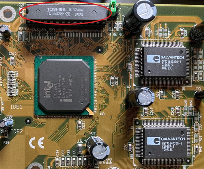

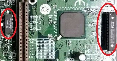

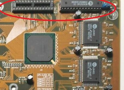

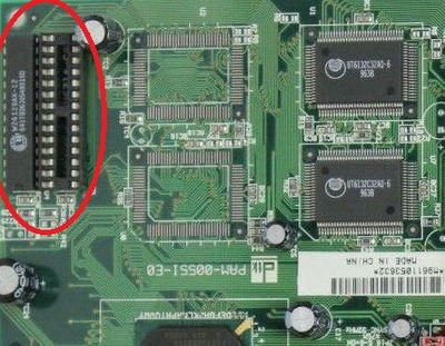

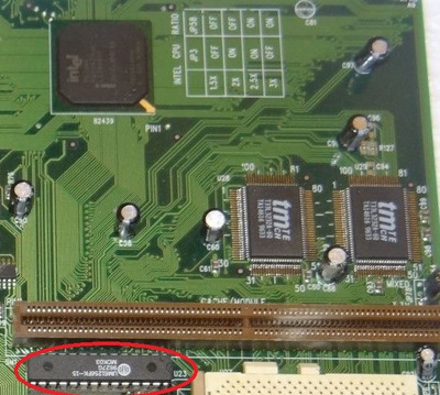

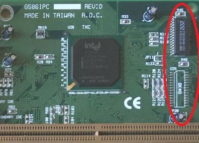

Reply 49 of 240, by majestyk
When it comes to the TAG-RAM for a HX setup like this it´s not about the size / capacity of the TAG-RAM but about bus-width.
You could even have a 32Kx8 (256K) TAG-chip annd would still be limited to 64MB cacheable area due to the fact that when you are using just one chip you´re restricted to a 8-bit bus-witdh (=8 I/O lines). This means the whole TAG-bus of the northbridge that consists of 11 bus lines cannot be addressed.
To fulfill this condition you need to add a second TAG-RAM chip that takes care of the additional 3 I/O lines for a total 11-bit bus-width.
In an ideal world the board manufacturer makes sure the wiring makes this possible by
1. providing 2 sockets for TAG-chips
2. connecting all 11 I/O lines to the COAST-slot (if there is one) and - most important - to the northbridge.
- If only condition 1. is not met, the daughter-board solution will work, or, if there´s a COAST-slot present you can use a COAST-stick that brings it´s own additional TAG-chip
- If condition 2. is not met the problems begin, especially when the BGA-pins of the northbridge are not connected to any traces and cannot be reached.
Some manufaturers (like Jetway, Soyo, Aopen...) did a lousy job here by sparing the COAST-slot, sparing the second TAG-socket, sparing the second TAG-chip, just putting 2 x 256K SRAM on the boards and NOT changing the layout. This basically turns the cacheable area of HX back to FX.
The good (Gigabyte, ASUS, Chaintech, Elitegroup and others) did it right.

Reply 51 of 240, by CalamityLime
Okay, SMD tag, it's not all lovely socketed stuff.
Is the circuit I layed above correct for the daughter board?
Be Happy, it's only going to get worse.
- Projects
Limes Strange 3D models
USB-2-232
Reply 52 of 240, by majestyk
I can´t find any mistakes, maybe put a 1K resistor for pull down in each I/O line (I/O4-I/O8) at "U2".

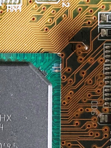

I wanted to test my prototype on the Jetway board but I couldn´t, because of it´s early death so it´s all from what I measured when inspecting boards with a working 2-chip solution, but I can´t guarantee that I haven´t missed some connection...
You can see in the Jetway picture above that I removed the coating on 2 traces at the upper-left corner of the HX BGA chip. While searching for the third one I had to get a wire as a probe under the chip and between the solder balls - this was probably the moment I damaged either some connection or triggered some ESD issue.
163.43 KiB
536 views

I measured the conductivity with a thin probe that reached the respective solder-balls underneath. This is possible for balls near the edge (1st or 2nd row), but the ball for the 3rd line lies deeper inside and is very hard to reach plus on this board there´s no unobstracted view from the side.
The soldering should be possible IF all three contacts have been identified. I´m not even sure if the third one is connected to a trace on the upper side at all.

Reply 58 of 240, by CalamityLime

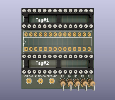

Hello
Sorry for being quiet, something came up and hopefully it's over now.
I believe I am done with the tag ram board. I included the source files in this post.
I didn't know what to call it on the sheets so I just put in "HX Dual Tag Ram"
-Lime
- Projects
USB-2-232
Reply 59 of 240, by Sphere478
🤔 maybe make resistors smd and hide em between sockets or under?
Looks like it’ll work though!!
Sphere's PCB projects.
