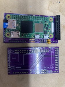

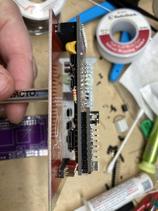

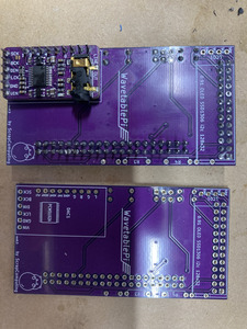

I’m really impressed with the v2 hw. The addition of wavetable and hard mpu support is just as great as the Gus support. I switched my v1 pgus out. I’ve paired v2 board with the mt32pi wavetable variant. It uses the rpi zero w 2. So far it seems to work well. All the mt32 games worked like wc1,wc2,death track,covert action
Using a switch program fluidsynth worked. I have not tried a massive sound font like timbres yet. I’m feeding the pgus output into the Line in of a als007 card. I put my x2gs on the als card so this pc really is a midi powerhouse now 😀
1.98 MiB
954 views
1.52 MiB
954 views
1.22 MiB
954 views
Here are some pics of the wavetable. Im really impressed with it for the price and capability.
It is a bit of a pain to get the rpi against the pcb. I didn’t bother with the dac and it does go into the next isa slot, but I have the room.
Edit: link to the wavetable pcb on github https://github.com/scrapcomputing/WavetablePi
