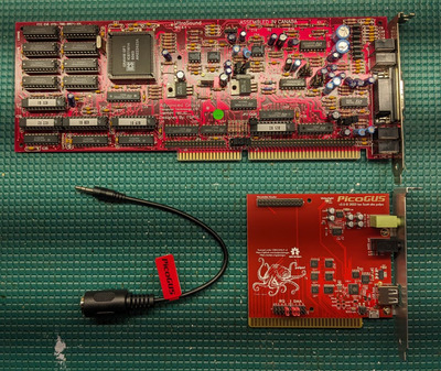

My PicoGUS arrived in today's mail. I had to snap a photo of it next to my original GUS.
