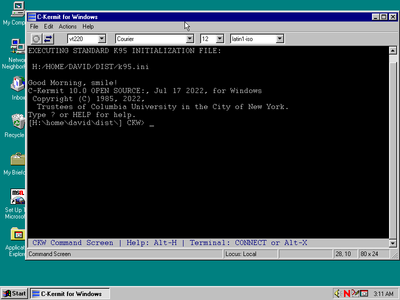

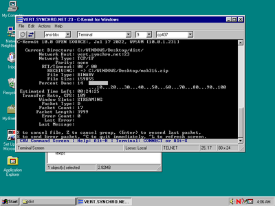

Possibly of limited interest here but I thought I'd mention it anyway.
What is it? A terminal emulator supporting telnet and serial connections. It emulates many different types of terminals and also supports file transfer using the Kermit protocol as well as FTP. There is some limited HTTP support there too (no https). The current build runs on Windows 95+ and Windows NT 4.0+ (3.51 may work - it had some UI glitches when I tried it a few weeks back).
Whats it good for? Logging into other computers via telnet or serial connections and transferring files using the Kermit protocol. Kermit implementations are a available for a lot of different platforms. Seemed to work pretty well with one or two BBS I tried it with the other day.
You can grab C-Kermit for Windows from the kermit project website here: https://kermitproject.org/ckw10beta.html.

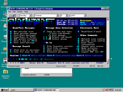

    Downloading from a BBS via the Kermit Protocol

    C-Kermit Command screen

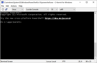

The big new feature is built-in SSH on Windows Vista and newer. Windows 10 version 1809 and newer also gets PTY support (pty cmd.exe will open the window shell inside the CKW terminal emulator). The SSH commands this uses are the same as those in Kermit 95, which are documented here though not all commands are implemented yet. See the included ssh-readme.txt for what works, what doesn't, and any known issues.
    24.16 KiB
    1268 views
    On windows 10 showing PowerShell running in a PTY

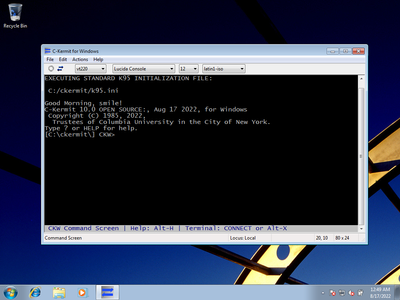

    349.04 KiB
    1268 views
    SSH-enabled Beta 2 running on Windows 7

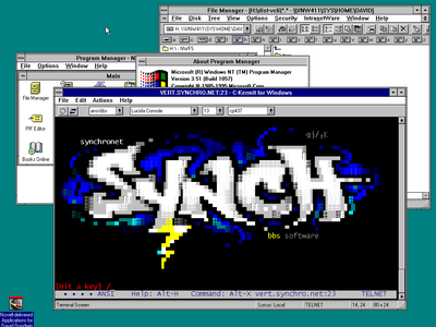

    27.54 KiB
    1268 views
    Beta 2 running on NT 3.51. The fonts on NT 3.51 are less good than newer windows.
