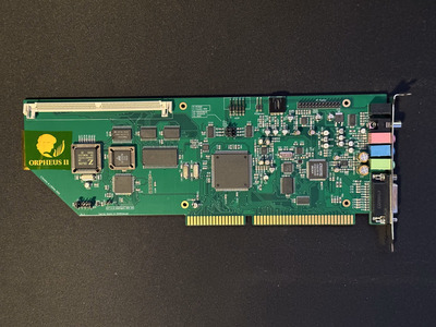

Paar wrote on 2023-02-24, 12:07:Just watched LGR's blerb video about Orpheus 1 and noticed the card has a problem with default volume of OPL3 chip vs PCM sounds. [...]
This has been discussed in the past and several attempts were made to correct this with orphinit but without success.
OrpheusI cards exhibit this with some games when you use external OPL3 , if this is a huge issue then switching to CSFM fixes this.
There is no way to "fix" OrpheusI cards when it comes to this - this is just the expected a CS4237 behavior - it's a silicon thing and thus "it is what it is"...
OrpheusII variants fixed this by doing things differently from what Crystal envisioned OPL3 interfacing should be, that is why it is now possible to install a dedicated OPL3 driver and have YMF289 usable under windows.
CS4237 still controls YMF289 , we did not just add an OPL3 at $388 and called it a day - like I mentioned before this is a result of knowledge over time and better understanding of how the CS4237 works.
Before OrpheusI noone really considered CS4237 as a good option for a DOS soundcard and no other CS4237 out there even has an external Yamaha OPL3 to begin with, so several things were just unknown and/or undocumented.
