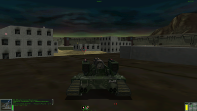

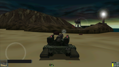

Hello,
I use Windows 10 64bit, dgvoodoo 2.79 and the green HUD text is completely missing when I use DirectX (on any resolution). The text is there with Glide,
but Glide crashes when I try to set the resolution to 1080p.
I attached 1 screenshot that shows the problem in DirectX (no text in the mission tab, no ammo counter and no health %).
I use a RX460 on that machine.
Any help appreciated.
EDIT:
The bug disappears when I use v2.55 from 2018 (I uploaded a screenshot).
So somewhere along the line a bug got introduced?

Reply 3 of 4, by Dege
Thanks!
2.74 is the last version working. After that I introduced performance optimization for DDraw surface GetDC/ReleaseDC but this game accesses the text surfaces by the CPU in a very unexpected, invalid way which is not completely detected by the optimization.
Anyway, I fixed it now. It'll be included in the next WIP/version.
