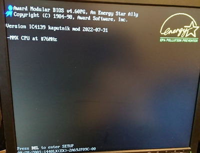

Trying to get a FIC VL-601 440LX board to work with a 667MHz Coppermine Celeron (SL4P9) in a MSI MS-6905 slotket.
Using the latest beta Award BIOS (ver. IC4139) unmodified, the computer will simply not post. Collected microcode for all 66MHz FSB slot1 and socket370 CPU:s, among them ID 00686 platform 10 parts, from the CPUMicrocodes repository, and patched the BIOS, replacing microcode for some 100MHz FSB parts originally supported. No real point in having support for them on a 440LX board anyways imo. Now it at least begins post with the Celeron, but freezes at CPU identification, text being somewhat scrambled. See attached pic.
I believe I did the BIOS patching correctly. The microcode storage structure is very simple in this BIOS, the blob is just the microcodes concatenated, without any header etc. The mobo still works perfectly with a Deschutes PII (SL2QH) with the patched BIOS.

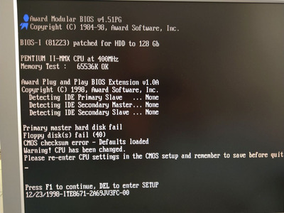

Reply 1 of 10, by Ydee
That's weird, I have a PC Partner with i440LX and in the modded slotket1 (Gigabyte) runs any Coppermine (Both Celeron and Pentium) even without the BIOS update. On the opposite, after editing the BIOS and adding microcode for Coppermines, I have only the black screen, although the board booted in the background. I had to return the original BIOS, so Coppermine CPU doesn't identify correctly and runs at a lower frequency (multiplier x 66-75-83 FSB max), but Windows work and can be installed.

Tried booting with a POST card installed. It stops at Award POST code 18, "Test 8259 Interrupt Functionality". Guess I'm off trying to figure out if there are any reasons the interrupt controller wouldn't like the Celeron 😜

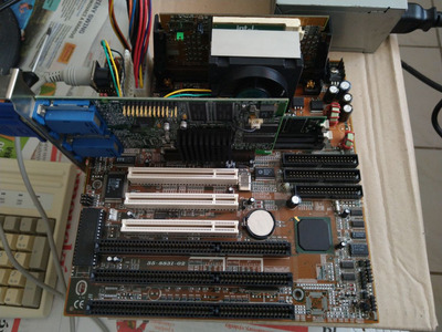

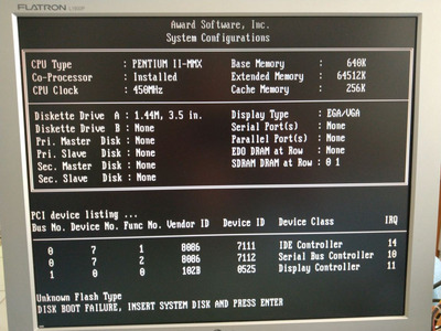

I am sorry, I have no time for extended testing and now is this mobo in paper box, but quick test I can make. Here you can see, how it boot up with P!!! 800 at 75 MHz FSB (slotket is Gigabyte GA-A7 simple passive slot1 to PPGA adapter, modded for Coppermine core) right now. Some months before I tested it with installation W98SE onto HDD too and it works like charm, but I dont have case for this mobo and HDD is used in another build. So, I can say, that on some mobos with i440LX can Coppermine cores sure work, but as you see, not on every.

Reply 4 of 10, by SSTV2
In this case, the problem lies in the CPU's detection routine, which simply halts the further progress of POST.
You can use a program called "BIOS patcher", which would insert new CPU detection routines into the original BIOS or you could look for compatible BIOS from other manufacturers, that support coppermine CPUs, or in the worst case, disassemble BIOS and manually include/exclude mentioned routines.

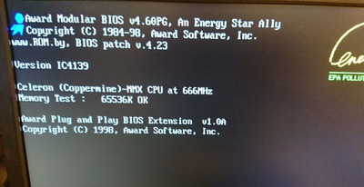

SSTV2 wrote on 2022-07-31, 13:06:
Though I had encountered two major drawbacks when pairing 440LX chipset with coppermine CPUs, first one - incompatibility with Windows NT 5.X OSes (WIn 2k, XP), due to the lack of 440LX SSE support and second - real AGP cards will stop functioning properly, not sure why, though cards which ignore AGP features works fine.
BIOS patcher did the trick! Took a few tries though. The auto patched BIOS wouldn't work, the computer would just reboot after initializing the GPU. Some hotflashing etc involved, and also general hair pulling caused by crashes due to the PII CPU I used when working with this not being properly seated. Thought it was the PLCC BIOS chip first, those can be quite sensitive to deformed/bent pins etc. Finally found a working set of patches by doing it manually, omitting the fixes I didn't explicitly need.
106.36 KiB
966 views
CPU-z reports everything correctly too.
Looks like you were right about the CPU detection routines 😀
