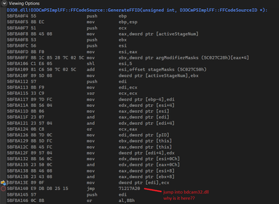

So, whenever I open Bandicam and go to any game to record with the recent versions of dgVoodoo, the games just crash right after it hooks (I suppose?). But this doesn't happen with previous versions, like 2.75.1, Bandicam hooks into the dgVoodoo's DLLs just fine. But I don't wanna use older versions of dgVoodoo, as the newer versions fixed some issues with a few old games (like True Crime: Streets of LA, that now works with it) that I'm interested in recording. I've tried every possible combination of settings, and nothing works, it's a problem with the DLLs' code itself. This deserves an update for sure.

Indeed, I tried the latest version of Bandicam in Gameplay record mode and it crashes with dgVoodoo. However, tracking down the reason of the crash shows that Bandicam hooks even d3d8.dll (not just d3d11/12), even before dgVoodoo is activated at all, and does it badly. I found a trampoline into the bandicam dll in the middle of a dgVoodoo function (see the attachment).
The first version of dgVoodoo that's not working is 2.78.2, the one that's compiled with the upgraded compiler toolset. I don't know why it matters, or how Bandicam does its hooking (maybe the PE exe header changed a little bit with the new compiler), but it definitely does not seem to be a issue on dgVoodoo part. 😐
