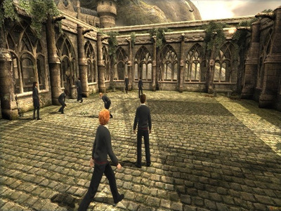

Reply 8 of 10, by Dege
Yes, it's the same game. One of the characters talked about quiddich and I played the game till that point, but anyway, I'm at the school yard (or sg like that):
This is upscaled from 1280x720 to 2560x1440. I had to run the game with GF 9800 card because the default supports paletted textures and the game has problems with them but anyway I cannot see anything wrong with the shadows.
Maybe I have a different version (patched) of the game? Or you set sg in the dgV config causing this?
