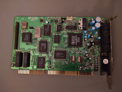

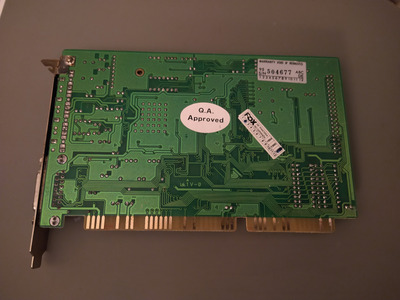

So here is the card OPTi 82C929A card I received:
1.64 MiB
1055 views
1.15 MiB
1055 views
I cannot find any brand/type the writing on the silkscreen yields no google results. It looks to me to be a generic whitebox design. It does sound quite decent though.
It has a Yamaho OPL3 clone (LS-212) and an OPTi 82c941 (AdMOS QDSP QS700) synthesizer with an AdMOS 1Mbyte + 128kbyte ROM.
It has one jumper, I suspect it is for disabling the wavetable.
The only problem is that it does not work in my 286 machine 🙁 The driver installer does run, but when it attempts to playback a sample, the soundcard produces distorted wite-noise and the installer reports a hardware error. I have tried all possible DMA/IO/IRQ settings, no luck 🙁
I started to suspect the card was broken, but then it worked fine when I installed it in a Pentium II machine.
When I tried the SB Vibra 16XV (CT4170) in my 286, it did work, but there also the sound was distorted; the sounds where recognisable, but mixed with white noise and rythmic clicks.
Any idea what could be wrong with my 286? (It is a Philips P2230 with a G2 chipset and quite a limited BIOS rom). I installed a Trident TVGA9000 and that is working fine btw.
