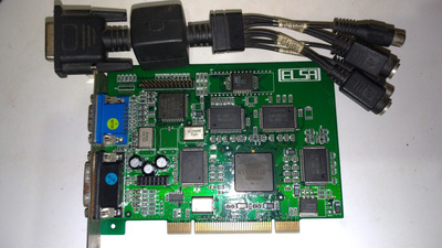

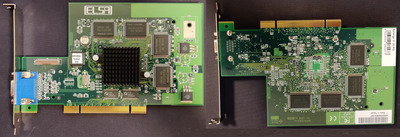

This is my first post and I want to share a few details regarding this ELSA Synergy II -32 PCI.
700.3 KiB
1758 views
Specs:
Bus: PCI
Chipset: nVidia Riva TNT2
Memory: 32MB SGRAM
Core Clock: 125 MHz
Memory Clock: 150 MHz
Memory Bus Width: 128 bit
Symptoms:
When the card was plugged in a PCI slot on an ASUS P3B-F, the system would boot without issues (no concerning beep codes), but there was no VGA output. The chip on the card got warm while booting.
Evaluation:
Since this card was meant for the professional segment, I suspected maybe a modified BIOS that locks this card to specific hardware (e.g. DELL, HP, etc.). Therefore, I tried to flash the BIOS of this card.
Resolution:
I added a second graphics card to the board to be able to boot and get a VGA output.
Then I tried several flashing utilities:
Elsa's own FlashRom (contains all BIOS images): Elsa FlashRom utility
Complained that the BIOS on the card is faulty. Could not read or write BIOS.
nVidia nvFlash:
Wouldn't work in DOS. I did not spend a lot of time with this tool.
Leadtek wfflash: Leadtek wfflash utility
Worked like a charm. Could read and write the BIOS. This tool rescued the card!
From what I can tell, the BIOS on the card differs in 4 bits only from the working BIOS image.
Seems like the BIOS chip flipped those bits over time (age or external influence) => Bit Rot?
The card is working now again:

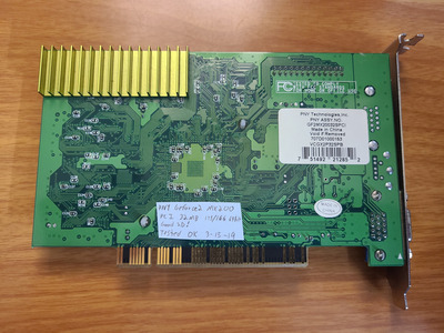

Great work fixing the card! I have a PNY Geforce2MX200 32MB PCI that has a corrupt BIOS too. No idea where I would find a BIOS image for it though.
Can you post some pictures of your card? I have a PNY MX200 PCI card that I've had for over 20 years. When I was in high school a classmate in one of my computer classes gave it to me because it was "dead". When he gave it to me it had what looked like an entire tube of Arctic Silver gushing out from under the heatsink and it was all over the PCB. I know that most reports say that Arctic Silver isn't conductive and is only minimally capacitive, but... that card was totally dead until I cleaned all that paste off. Then it worked fine for years.
Anyway! Post some pics of your card. If it's the same as mine I can see if mine still works and try to upload the BIOS for you.

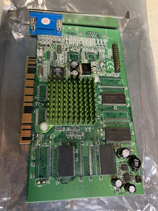

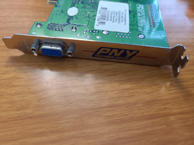

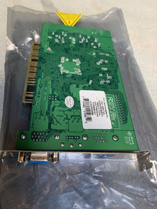

Here are the pics of my PNY MX200 PCI 32MB:
Reply 8 of 15, by Ozzuneoj
Aaron707 wrote on 2023-02-26, 00:55:
Thank you for responding. This is a great idea, Find the BIOS from a working card to re-write mine! I wonder if vogons could sta […]
Ozzuneoj wrote on 2023-02-22, 18:29:
Aaron707 wrote on 2023-02-22, 02:25:
This is a great idea, Find the BIOS from a working card to re-write mine! I wonder if vogons could start a repository to keep these old cards alive. Even if the BIOS files were hosted somewhere else like Archive.org. I suspect as time goes on more a more cards might stop working due to bit rot of the vga BIOS.
Your card looks very similar to mine, though the capacitor layout is a bit different and mine has a matching green heatsink on the back of the board behind the voltage regulator. Come to think of it... that's a pretty weird feature! I've had this card for so long I've never even thought about it. I don't think I have any other cards in my collection with heatsinks attached to the PCB to absorb heat from the VRM. How strange! EDIT: Managed to find one other picture of this card online... seems pretty uncommon.

Anyway... I don't know what the best method is to dump a video BIOS without pulling the chip and using an EPROM programmer\reader, but I used NSSI under DOS which has a convenient "Save Video BIOS" feature. It saves them in .vbi format, but I would imagine you can rename this to whatever extension you need, assuming this is just raw data.
I have attached the file, plus pictures of my card. I hope it helps!

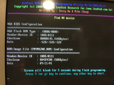

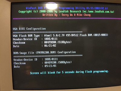

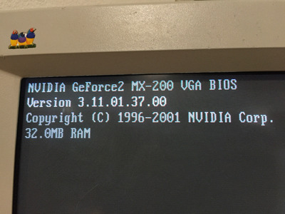

Ok, thanks so much for this BIOS. My card before would not even allow the computer to POST when installed. So to flash it, I booted to DOS, and um installed the card in an empty PCI slot (no other cards installed). Then used the
Wfflash app, it could see something, but didn't have correct data or flash rom type, so rebooted the computer and it came back up and saw the card in Wfflash (sort of, showed "Find NV device" at top of screen still). Flashed the BIOS and now the card allows the computer to POST normally and outputs a picture at the BIOS screen but the computer wont boot into DOS or Windows with card installed. Just goes to a blank screen after BIOS splash screen and never shows anything or any activity. Comparing the BIOS dates, it appears the one I dumped from my card (had a strange checksum) was 51KB and showed a date of 06/21/02, and your PNY BIOS shows a earlier 9/21/01 date. I am wondering if I still need a different BIOS (newer) before it will work. Attached is the dump of my corrupted BIOS if anyone wants to look at it (I have no clue). Anyways I feel I am closer to making this card work, but just not quite there to have it fully functioning.
