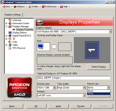

Hi, i need some help, im stuck here
My main computer have a 1920x1080 TFT and a CRT,Windows XP 32bits
Before i have a 8600GT and i use 70hz for dosbox in tft and crt
1920x1080 70hz was working fine, and i was happy in TFT, and im CRT i have all native ones
I upgraded to a ati hd5670, but now im stuck in a maximum refresh of 60hz and no custom res, i dont see nothing in ati panel
even the integrated intel have custom refresh and res option
I tried winmodelines and no luck, im stuck because is my first time with ati beyond old ones
Any ideas? thanks

Are you using DVI, VGA, or something else? Have Catalyst Control Center installed?

I tested in DVI and HDMI, and yes, i have CCC, and 60hz max there. My only options are 25/30 interlaced, and 50/60 progresive. I changed monitor driver (generic pnp, svga, originals and custom 50-75mhz i made with powerstrip) but no change
This TFT with integrated intel and nvidia is up to 75hz, then is not monitor, is the ATI
