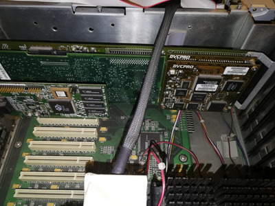

Hey,
I'm writing here because I'm out of ideas and I'm hoping someone might have a solution to my problem. Well, I recently got my hands on a film editing station - AVID Newscutter DV. It is running Windows NT 4, unfortunately the disk died and I was forced to reinstall. I managed to complete most of the drivers needed to make it work except for one - the most important one. This computer is equipped with a Truevision TARGA 2000DV capture card. And this is where that 'DV' suffix comes into play. It's probably some version specifically made for AVID. There were two drivers available online - version 1.71 from 1996 and version 2.2 from 1997, however both are for a card without 'DV' in the name and do not work with mine. I've been trying to recover data from a corrupted disk and have found fragments of the correct drivers - it turns out that the ones I'm interested in are version 1.1 but from 1998. And they are created specifically for TARGA 2000DV. Would anyone happen to have the correct drivers on hand for this card? I would be very interested.
I only have the 1.71 and 2.2 drivers for the 2000 version (without the "DV" in the name) and the 1000 version, so I could share them (as I've seen that they can't be found on the modern internet). Thank you in advance.
