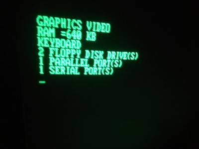

Seems to be more myth than true. Most of 8080-based "home PCs" used TV sets as a display. 8088/8086 which were "professional" an […]
Jo22 wrote on 2023-01-07, 08:04:
Another thing I read online was, that Hercules Monochrome graphics
was apparently very popular in the early-mid 90s, not VGA.
8088/8086 which were "professional" and "industrial" almost totally relied on CGA and included a bunch of remarked US chips.Check this one for example 😀
Hi again, I've just found the source that I remembered this from. It was in the comments of that "Super CGA" video..
I was born and grew up in ex soviet union. And it's super funny how the timeline was all skewed for us. Here even in the early 9 […]
Here even in the early 90s computers with VGA were super rare. When the soviet union collapsed they began popping up.
But then again Hercules graphics were super popular. Most all 'home brew' I remember ran either hercules monochrome mode or CGA colour mode.
When I was used to hercules graphics CGA looked a bit like a step backwards because of the lower resolution.
Source: https://www.youtube.com/watch?v=xNsK_F4JlG4
The CGA thing is something that I remembered independently of this Hercules-related comment..
- I can't judge about the comment, however. I wasn't there, after all. I just re-watched this video a few minutes ago by accident. 😅
However, in an 1980s issue of German CHIP magazine, there were photos of eastern PCs in school/university running Norton Commander and Tetris.
These PCs looked both very futuristic and low-tec, simultanously. The text resolution on the screens were blocky, CGA-like, if my memory serves me right.
So it made sense to me that Hercules was a logical upgrade. Hercules could even emulate CGA, due to its second video page being in CGA space (Page 1).
CGA was also compatible with conventional TV technology (15KHz, 50/60 Hz),
so in theory it could work with primitive video monitors and modded TVs.
An NTSC video signal can be displayed on a PAL/SECAM screen in monochrome,
if the the V-HOLD knbow is as adjusted accordingly.
By-passing the TV-tuner to make yourself your own video monitor wasn't exactly new,
it was even mentioned in the manual of the Robot Model 400 SSTV Converter from the 1970s.
It warned about the problem with the hot chassis, if I remember correctly.. 🤔
The German Nixdorf PC (-made in 1985, afaik-) that I have here has CGA on-board, too.
The RCA / Cinch connector does display a monochrome video signal only, no color-bust signal.
Sadly, I have no manual. Would be cool for checking the hidden dip switches. Could be that the PC secretly has Hercules mode, too. 😁
VileR wrote on 2023-01-10, 18:44:
I don't know, seems like there were plenty of USSR/Eastern Bloc CGA clones with Cyrillic text, which isn't less readable than English/Latin (examples: https://github.com/viler-int10h/vga-text-mode … UGENC1D.F16.png, https://github.com/viler-int10h/vga-text-mode … AT-RMCD.F16.png)
Same for stuff like Greek or Hebrew; even Arabic can be quite readable. Of course logographic CJK scripts are a whole other story.
You're thinking of RGBI monitors likely. But 80x25 is hardly readable even on a composite monitor or colour TV, even for Latin characters..
Someone who still can decipher Greek or Hebrew on such a CGA display must be a trained native speaker, I suppose. 😁
However, I admit, a true green/amber monitor with a single tube ray gun is kind of okay for CGA (via RCA/Cinch output) .
- Pure VBS without any color information (CCIR instead of PAL, RS-170 instead of NTSC) was something akin to the RGB of the monochrome era.
In fact, there are analogue monochrome video monitors with over 1000 lines.
They use BNC connector instead of RCA, however. The main application is or was video surveillance, I think.
Edit: A few edits (at home on PC).
Edit: Pictures added.
Edit: I'm sorry for this little off-topic small-talk here, but I felt I should mention it, so I did.
I hope you don't mind - I seriously didn't think of posting in this thread until I watched that "Super CGA" video again.
    1021.35 KiB
    1553 views
    CGA on a green monitor (no color information)

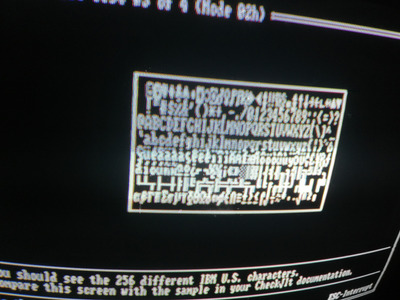

    616.7 KiB
    1553 views

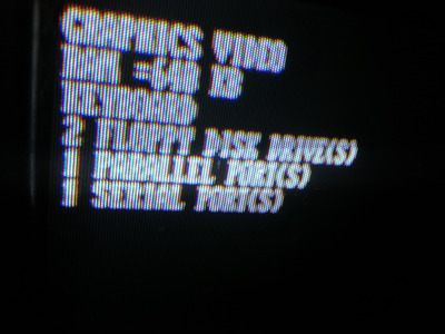

    CGA on a blurry colour TV (no color information)
    1.79 MiB
    1564 views

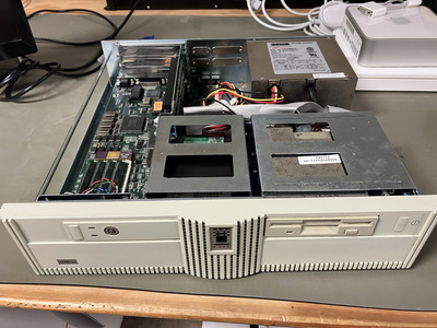

I came across this post and while I have been “lurking” around here at vogons; this is my very first post.
I got a Tandon 286/n (not mine eBay listing by the way) and it has the same mainboard as your USIT Athena PC!
It’s a:
U.S. INTEGRATED TECHNOLOGIES, INC. ATHENA SMT-216LP
Or a:
Western Digital WD286-LPM
But I think they are basically the same mainboard with a Faraday Chipset (I have to spin up my Win98 machine to look it up in my Micro House Encyclopedia for the exact chipset).
If you have any questions, let me know, I’ve been playing a lot with this PC 😀
If I may, I got a question for you:
Mine has an AMD 286 @ 12MHz CPU, I ordered a NOS 16MHz one on eBay and I was wondering what the jumper settings are that your board is using.
According to the jumper settings in the manual, the settings for Jumper W9 are the same for 12 and 16MHz CPU’s (pins 1 & 2 closed), but I suspect that one of the “ Factory configured - do not alter” jumpers, W5, W15 or W17, need to change for a 16MHz CPU.

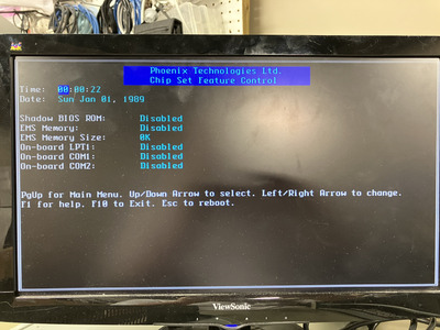

Maybe a bit talking to myself here, but if anyone is searching or interested:
MM.ZIP
10.73 KiB
50 downloads
EMS driver for the WDC FE3021 memory controller
Not that I get any expended memory on my Tandon 286/n (probably it needs to be set in the bios, but there isn't an option for it), but maybe it is useful for someone with the same board, it supports LIM 4.0.
external setup for Phoenix BIOS.zip

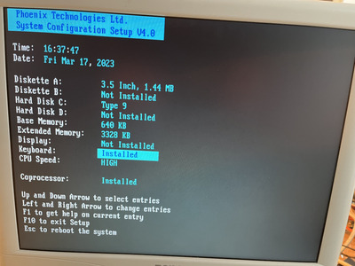

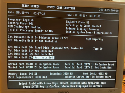

External setup for Phoenix BIOS
1.63 MiB
1366 views
1.84 MiB
1366 views
BIOS
EDIT: added pictures.

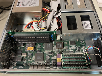

By the way, here is my Tandon 286/n with the same motherboard as your PC:
Tandon 286/n

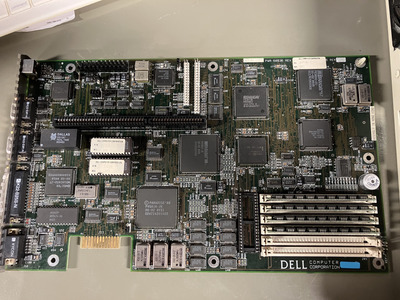

The Dell System 210 uses this same motherboard.
Dell bios of course, and they set theirs to only run at 12mhz with 6mhz bus.
The white paper on this Faraday chipset says it supports up to 20mhz 286 cpu's, and runs the ram at 0.7 wait states.
My Dell 210 has a dead board, but the Athena you have here should be a very fast 286.
USIT also made a 25mhz 286 system, would love to find one of those!
Faraday was bought by western digital, so to find the info on this chipset, search for the WD FE3600 chipset technical manual.
OK, after verifying pics, the Dell 210 version of the motherboard is a little different, but its obviously based on the same board.

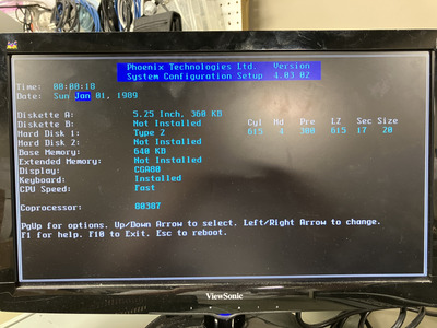

Woohoo!
I scored a USIT Athena too 😁
This one has the hard drive carrier so you can see how its arranged.
We both have the same BIOS revision.
The Dallas battery is dead, but I have a new one ready from Glitchworks, just not with me at the moment.
For the EMS memory, just go to the second bios screen (press PageUP) and set it to enabled, then how much extended ram you want to use for EMS.
