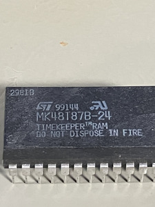

Wanted to update, of course the clock module battery is dead.
I replaced it with my Glitchworks and although it did work for bios settings, it s aid the time of day clock was stopped.
I'm guessing I need a different module, need to research since the one in the computer isnt a Dallas, its an ST:

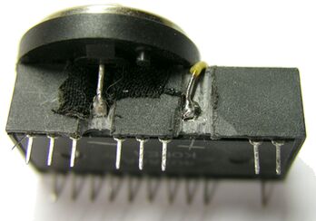

a) The old module can be fixed. Coin cells are harmless, just disconnect one of the power pins (hidden under plastic, maybe)
and install an external battery via cable (coin cell holder, 2x AA holder etc).
See http://www.mcamafia.de/mcapage0/dsrework.htm

I was able to find some working Timekeeper modules on ebay, so that problem is fixed.

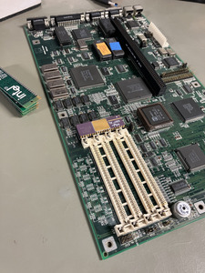

Got some intel branded 1mb parity simms, and they work properly.
The old simm slots are cracked and some of their plastic clips are broken, but I found new amphenol metal clip sockets to replace them.
The only problem left seems to be that I cant get the board to boot off my adaptec 1542 scsi card, it sees it and the card seems to work fine, I can even format the drives using a boot floppy, but it motherboard refuses to start from scsi.
This is with no IDE connected. There seems to be no way to disable the IDE controller on the board.
I'm still picking away at it, I had really wanted to use the excellent 1542 scsi and a scsi2sd unit for its drives.

I replaced the simm sockets in my board with the nice metal clip new ones.
Still no luck getting it to boot off my Adaptec AHA-1542CF card, it has the boot bios and should work.
Running it just off floppies, its working great.
I hooked up a Gotek floppy emulator unit, works great with that too.
I dont have any IDE drives that are small enough and still working to test with.
I did hook up a compact flash 128mb card, and after manually putting in the CHS settings, the drive comes up in dos, and I can get a DIR list, but if I try to execute anything off it, the computer locks up.
I'm beginning to wonder if the board has a failed IDE interface.
