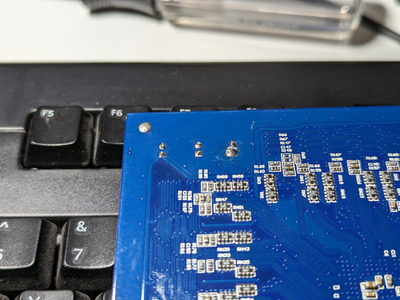

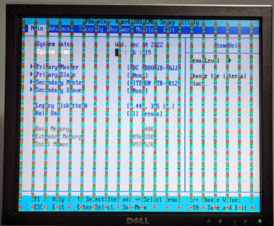

Symptoms: Installed it, powered on, was good for 30 seconds, then saw these lovely vertical stripe problems. Rebooted the machine and the stripes were there from the POST. Powered off the machine, checked connections, then booted it back up. Sure enough, the stripes came back after about 30 seconds. So it seems there's some thermal component in the problem, like the card warming up triggers the artifacting. This behavior is the same in both my P2B and A7N8X-X boards, on two different monitors, using different cables, and on both VGA and DVI outputs.
The card was listed as "refurbished" and I can see that two capacitors were changed out: one surface mount and one normal cylindrical. As you can see, the soldering isn't the greatest quality. This was the main reason the seller gave me a refund because they figured they went too hot on the iron. On first contact, the seller asked me for a few confirmation photos and tests. Understandable. I did the tests on the A7N since I'm more willing to risk that board should the GPU damage the AGP slot. During some of the tests, I'm not sure if somehow the card got seated better in the slot or something else changed, but it went nearly an hour without any problems. Long enough for me to install 40.72 XP drivers and start a game of WarCraft III.

clean all the dust off with a soft toothbrush and alcohol, let dry, test.
if still doing it; check the solder joints, maybe reflow, if you can do that fine of pin pitch.
if that doesn't solve it, one of the chips (or several) may be bad, or traces broken that connect to the chips, which isn't so easy to fix.

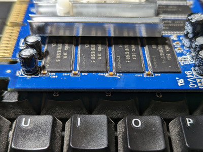

but its definitely the ram or the connections to it.
these boards sometimes will allow you to pull the top set of chips off (cutting the mem in half) and still work okay, but that should be a last resort as its not a universal thing, and some of these cards just won't work at all without all the ram spots populated.
i'd hazard a guess to say however, since its starting at the very edge of the display output, its probably in 'bank 1', aka the 4 chips in pic3, partially under the edge of the heatsink, be it dust bridge, cold solder joint, or failing chip.
