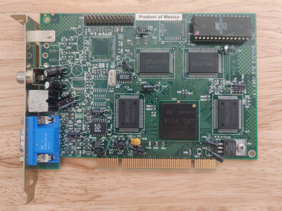

I have no idea what would cause bit rot or otherwise corrupt a PROM like that though. Just curious... was your card one of the ones with the through-hole caps with the legs left super long, like this one? I thought they were SMD pads, but they are in fact going through the board...
(not my picture)
348.23 KiB
364 views
That is how my card looks and it is... really baffling. In my experience, STB always produced rather high quality devices. This is such an incredibly shoddy looking way to populate a PCB, I have no idea what they were thinking unless there was a problem sourcing the correct caps at the time? It could be why a lot of cards in the late 90s used SMD tantalums instead. I know the AGP versions of this card use tantalums... I always assumed there was some difference in voltage between the PCI and AGP versions of cards, which is why the passive components are often different between them.
Anyway, it wouldn't surprise me if there was some connection between this crazy capacitor setup and a corrupt PROM.

Yup, screwy as all hell, they're the same caps as on my Nitro 3D from basically the same time, however. On the Nitro, they're basically flush with the board. I pulled the PROM while I was soldering and it worked fine afterwards. The 128 seems to be an odd one all all around, because this is the same card that STB decided to thermal glue a mosfet heatsink to the package when they realized it would benefit from a heatsink: I found that utterly nuts so I popped it off and stuck a large rectangular Raspberry PI heatsink on it. If I had to guess: the difference between the AGP and PCI versions (tantalum vs. electrolytic) may be down to cost cutting, but who really knows.

Haha, yes, mine has that mosfet heatsink as well! It's crazy... I have seen so many of these over the years I'd just gotten used to that stupid cooler. It never occurred to me that it is possibly the only video card I've seen with such a hilariously misapplied cooling solution.
Wow... this card just got weirder, for sure.
Would genuinely like to talk to one of the people who had to approve these design choices.
