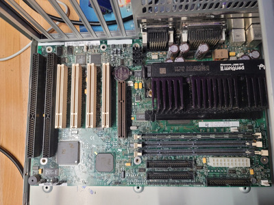

I recently got this interesting 440LX Slot 1 motherboard. I believe it is from a Sony Vaio PCV-210 or 230 but I am unsure. It is a neat board. Has integrated Yamaha OPL3 and OPL4 chips onboard. Similar to several other 440LX Slot 1s that inhave that are Dell and Gateway OEM'd. No integrated video though. Only audio.
Curious if anyone is able to identify this board and where exactly it came? Will 440LX drivers work or should I attempt to locate a Sony disk for this machine?
Has a cute little musical jingle on power boot. The OPL3 chip seems to be picked up in Windows 98 SE but curious if drivers are needed for the OPL4? Curious if Yamaha 718S / 719 drivers might work.

Reply 2 of 12, by Vanessaira
Cloudschatze wrote on 2022-12-28, 04:01:
Sony's PCV-2xx systems do indeed use that motherboard... […]
Have access to any software or drivers by any chance? Do I need to do anything to get OPL4 working?

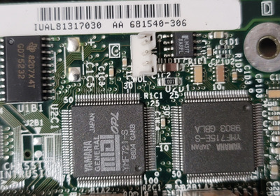

Nothing that you know of for the onboard OPL4?
1.44 MiB
884 views
An Analog Girl in a Digital World
Reply 5 of 12, by Cloudschatze
Vanessaira wrote on 2022-12-28, 05:28:
Not with my setup at least. That is, the YMF721 behaves as an external/standalone MIDI synthesizer (like a Wave Blaster on an SB16), and responds to any playback directed at the YMF715E/OPL3-SA's MPU port.
Reply 7 of 12, by Vanessaira
So I finally got a chance to work more with the system. Does detect and use both OPL4 chips in windows. However the MIDI playback will slow down and change tempo if you move the mouse or around on the keyboard.
Presume there is some kind of IRQ or DMA conflict??? Happens inside Win98 and outside in DOS.
Reply 8 of 12, by Grem Five
Just a standard Intel 440LX board, my Micron has one identical to this. I believe the yamaha chips were an option from intel on those boards for the manufactures to decide on.
I have seen that board with the yamaha chips from Micron, Dell and Gateway (Not 100% positive on Gateway) machines as well. Sometimes you would find the 715 chip and not the 721 and other times with both (most the time with neither). I didnt not know they had those in Sony machines but does not surprise me.

Reply 9 of 12, by Cloudschatze
Vanessaira wrote on 2022-12-29, 06:43:
I haven't experienced this myself, but one reference suggests disabling "Legacy USB Support" in the BIOS as a possible solution, if currently enabled.
Reply 10 of 12, by Vanessaira
Superb news. That was definitely it. Working well within system. Now I just need to figure out why certain games are not saving their music settings. Raptor for example will not see any music device and keep resetting to GUS after exit saving and re entering the setup.

Reply 11 of 12, by Bruno128
Hi Vanessaira. Here it is the board you own, AL440LX. You will find manual and other info in the downloads tab.
Because your variant also has YMF we kindly ask you to contribute with a photo (see bottom of the page). In the meantime we'll put the Sony OEM information there.
