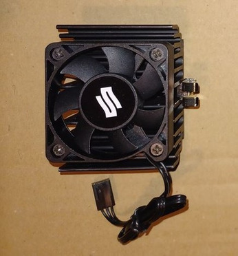

I would like to buy a socket 7 PPGA Intel Pentium w/MMX Tech which top surface is not ceramic. Like SL27S model with 296-pin PPGA (FV80503233).
Can I use a "normal" socket 370 cpu cooler like Startech FAN370PRO or similar? I'm concerned about the components that are exposed on top surface.

Yes, I have one of these StarTech coolers and it can be used on a Socket 7 CPU without any issues.

Also have a variation of this cooler. Works great for 233 MMX. Just added more silent fan (~3000-3600 rpm).
