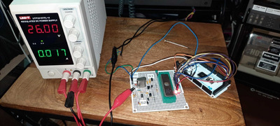

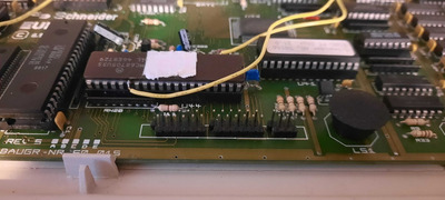

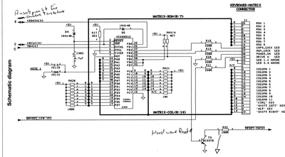

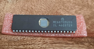

- the keyboard (micro) controller in my Euro PC was dead. It is possible to put in a Motorola 68705 substitute which can be programmed (EPROM). A jumper needs to be changed on the board. A guy from https://www.classic-computing.org/ was able to retrieve the firmware and put it in an Arduino sketch. You will still need to build the Motorola programmer board, but it connects to an Arduino Mega rather than an EPROM for the firmware container. It's not difficult to assemble, but a bit of a project. I can supply replacement controllers if required (-> PM).

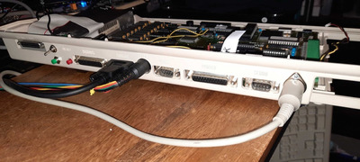

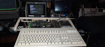

- the keyboard membrane of my Euro PC is irreparably broken (actually, it's not a membrane, as it only has one layer, but it's still conductive ink printed on mylar). Another attempt to source a substitute keyboard from eBay got me an even worse extra membrane. So I am going to create a PCB substitute now. In the meantime, it is possible to just connect a standard XT keyboard to the Euro PC. But not all XT keyboard will do; it requires a certain "code set". I am attaching an image.

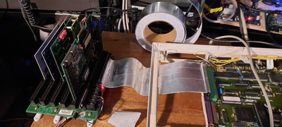

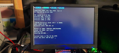

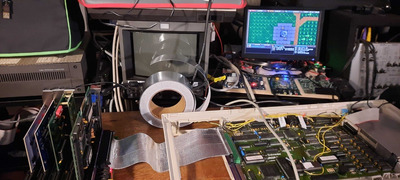

- it is possible to extent the Euro PC drastically. I have acquired an external ISA backplane extender, and connected it to the Euro PC. My Euro PC now has the CF XT-IDE, a 1 MB RAM expansion, an Adlib clone, a VGA card, and EGA card (only one at a time of course), as well as a MPU401 MIDI card recreation. One issue is the required ISA connector cable, which you can create from https://oshpark.com/shared_projects/cG4aZUEg . The cable absolutely must be shielded! For this purpose, I found something much better than Aluminum foil. See pictures attached. DO NOT draw power from the ISA cable; use a backplane with extra Power Connectors. I just routed a second set of 5V, 12 V, -12 V to the same MeanWell that also powers the Euro PC. Works well, and the whole set draws less than 2.5 Amps with all cards plugged in, so it's well below the limit for the MeanWell.

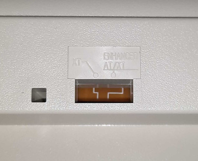

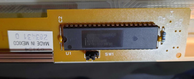

Here is a hint regarding the external keyboards. It has to be a DIN XT only protocol keyboard. Of three DIN XT / AT keyboards that I acquired, only one worked. A keytronics one. And that only after I populated an internal jumper and set it to XT. The keyboard bottom case gave it away - at some point, they sold the keyboard with a switch, but it wasn't populated. I opened it up, soldered in the jumper and set it to XT only (not XT/ AT enchanched which is the default in most XT DIN keyboards). After that, the Euro PC started working with the external keyboard.
So, AT ~ XT/AT enhanched ~ PS/2 ~ USB keyboard - and that does NOT work. The Euro PC / Faraday chipset needs the old-style "XT only" protocol.
