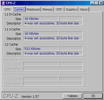

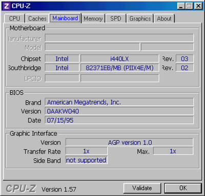

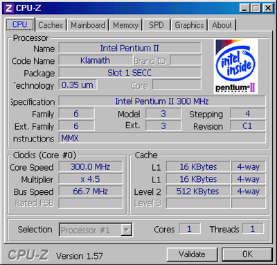

I am using a Microsoft Intellimouse with a Scroll Wheel (PS/2), my system has 128MB RAM, a Pentium II 300MHz processor, a Voodoo 3, and a Sound Blaster AWE32. Images from CPU-Z from Windows 98 SE can be found below in the attachments.
