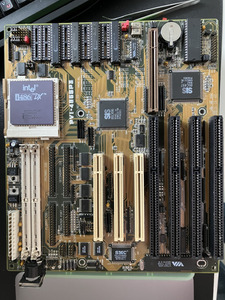

Couple of weeks ago I bought non-working ASUS PVI-486SP3 motherboard (rev 1.22).
After installing the i486 DX-33, RAM, cache, video card I tried to start it, but no beeps, POST codes, etc. However, CPU was going warm, and all Vcc pins had 5V, so that gave me hope for the board to be restored.
I found that:
- resistors R61, R62 are desoldered or broken out
- AMIKEY-2 chip is very hot
I soldered back the resistors (‘100’, 10 Ohm) and replaced AMIKEY-2 with VIA VT82C42N.
Also I checked operability of the BIOS chip (p28f001) on another mobo.

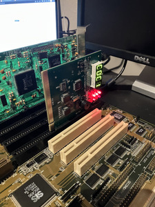

After that the POST card showed me the code C0.
Active LED’s: -12, +12, +5, CLK, FRAME
Further efforts were unsuccessful:
Tried to install another CPUs - fail
Tried to replace cache chips and different SRAM/RAM (FPM) configurations - fail
Tried different frequencies - fail
Checked for the scratches on the board - found one track slightly damaged but working.
Checked the soldering of the chipset chips - everything is fine.
Checked motherboard power pins for shorts - everything is fine.
Tried to send RESETs - sometimes post code changed to C0/C1 or C1.
I even tried to install the CR2032 but still no luck. 🙁
Any ideas what else can be done? any help will be highly appreciated 😀
Thanks,
Slava

Reply 2 of 4, by rasz_pl
Im guessing its Late Award BIOS (4-5x PnP)
C0
1.Turn off OEM specific cache, shadow
2.Initialize standard devices with default values:
DMA controller (8237)
Programmable Interrupt Controller (8259)
Programmable Interval Timer (8254)
RTC chip
C1
Auto detection of onboard DRAM & Cache
looks like C0 is the first post code. Try removing everything, all cache chips, ram, vga, keyboard controller
Reply 3 of 4, by Disruptor
Please remove the cache modules and try again.
The cache is useless without TAG ram chip.
On the picture your board is configured for 40 MHz.
Try a lower clock frequency.
And try to use an ISA graphics card, perhaps a stupid model that does not need much BIOS initialisation.
Reply 4 of 4, by debs3759
It looks like one jumper is missing from the CPU type block. Take a look at the settings page included here.
