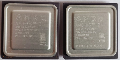

Reply 44 of 85, by aitotat
Started testing K6-2+, or rather K6-III+ since it is unlocked. This is going to take a while. I kind of assumed that with L2 cache disabled it would perform the same as K6-2. But no, it does not. So for all the possible combinations, I would have to test this with all multipliers, both caches enabled, both caches disabled and with only L1 or L2 cache enabled. And then repeat all that with 75 MHz bus speed.
There seems to be very little difference if L2 is enabled or not when L1 is disabled. Is this normal? I expected that with L2 only I would get quite nice slowdown results but that does not seem to be the case. In fact, it looks like K6-2 with L1 disabled is a bit faster than K6-III+ with L1 disabled and L2 enabled.
Edit: With L2 cache I mean the L2 cache inside the plus-CPU. I'm not going to disable motherboard cache in any of the tests.

Some K6-III+ benchmarks added. Results with 75 MHz bus are missing. I'll do those next week but not with that many multipliers. It can be seen that it is enough to test 6x, 2x and maybe some from between. I didn't test every possible combination with 66 MHz bus since it does not make sense to test those half multipliers. They don't really make any difference.
Ability to change multipliers seems to be not necessary with 66 MHz bus. With 100 MHz bus things are likely different and you can easily avoid the "200 MHz bug" (500 MHz bug on a K6-2?) by changing multipliers. But that is not needed here. You need to disable CPU cache(s) for perfect OPL3 compatibility (and that about 486DX33 speed is also great for Sierra games with speed bugs). And to get down to the 386-25 level for Wing Commander you need to disable motherboard cache as well. And those are available with every CPU. So the ability to change multipliers is not needed at all (maybe there are some rare cases where it helps. Let me know what those are).
But the plus-CPU is the fastest you can install on this motherboard and it runs cooler than regular K6-2 or K6-3 so that makes the plus-CPU best because you can have everything with it, slow speed and fastest speed. And if you don't care about speeds above MMX-233, then you can use 50 MHz bus with the plus-CPU. That way you can get 16.0 from 3DBench (multiplier 2) and speed above MMX-233 (multiplier 6). Then you don't need to disable motherboard cache and that is the only case when ability to change multiplier is useful.
Well, almost the only case. For some reason the system does not post when multiplier is set to 2 (=6). It does post with K6-2 but not with the plus-CPU. So I set it to multiplier 1,5(=3,5) and then used SETMUL to set the CPU to 6x. Maybe a BIOS issue?

But nothing beats K6-3+. With 66 MHz bus you can get 3DBench score down to 11,2 and there will be many combinations to get great "safe" 486 speed. But no matter what the speed, Indy "486" always requires the "a" command line parameter when using K6. With 75 MHz bus you get 3DBench score down to 11,7. Again a great result. And at their fastest speeds K6-3+ is in completely different performance group than Pentium Classic or MMX. So if you have a motherboard that supports the plus CPUs, then the K6plus CPUs are simply the best.
But I'll choose the Pentium Classic 200. It is a great 1996 CPU. But wait, what about the Pentium 150 with 2x75? It seems 75 MHz bus is too fast to get Indy "386" to work with 486 speed. You need to go down to 386 speed to get it working and that requires disabling L2.
About L2 (L3 with K6plus CPUs). Disabling it is necessary to get down to 386 speeds. I'll investigate it further. I'm sure some software solution can be made to disable it without need to go to the BIOS to do it. But that can wait until the system is build and otherwise ready. Next there will be many graphics cards to test (with the Pentium Classic 200).
Edit: One more thing. K6-3+ 450 MHz (6x75) was free from the "200 MHz" Turbo Pascal bug (Runtime Error 200) . So it did not affect any of the tested CPUs.
