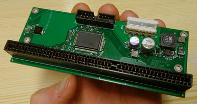

Reply 266 of 518, by LSS10999
anton23 wrote on 2023-12-20, 09:47:
Quick question, how hard it is to solder these adapters ? Or do PCBWay or other are able to fully populate them on order ?
It would be interesting to see a picture of both sides of the adapter, I did not find one.
As of v0.2/v0.3 there are no parts on the other side of the PCB, though for v0.2 (v0.1 also) you'll need an additional resistor between two adjacent ISA slot pins to fix an issue.
You'll want to start with F85226 first. If you're good at drag soldering it's not the hardest component to solder, just make sure it's positioned and oriented correctly.
As for other SMD parts, resistor arrays can be difficult due to them being relatively small, but SMD resistors, caps, fuses and LEDs should be easy. Should note that all five LEDs have the same orientation. The + markers on the LED footprints for negative ones are misleading.
Most through-hole parts shouldn't be difficult, either. You'll want to start with the caps and headers then the ATX and ISA slot connectors. That leaves only L7905 which is the tallest and also the most difficult component to solder.
I think a higher solder temperature may be needed when doing L7905, because its heat spreader will divert the heat from the soldering iron (as well as the tin) which could interfere with the soldering process.
IMO it's not difficult to solder in overall but it's not easy to ensure everything works. You'll want a good magnifier to be able to carefully inspect and verify everything's soldered correctly, and without bridges (especially F85226 and resistor arrays).
PS: While the BOM specified 1K for resistors connecting to the LED, in my case it's a little too bright when operating. Perhaps increasing these resistors a bit could mitigate the problem.

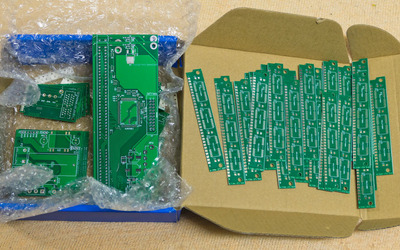

My PCBs including LPC2ISA just arrived today from JLCPCB so I started with component assembly. 1st I have to try SMPS inverter if it works properly...
Gigabyte GA-P67-DS3-B3, Core i7-2600K @4,5GHz, 8GB DDR3, 128GB SSD, GTX970(GF7900GT), SB Audigy + YMF724F + DreamBlaster combo + LPC2ISA
Reply 268 of 518, by RayeR
Assembly completted. I only tested the DC-DC SMPS yet and it seems to work...

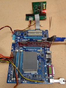

My 1st test in PC was not successfull. I attached it to my Gigabyte GA-P67A-D3-B3 with LDRQ1# mod and put ES1869F in the ISA slot. I run SAPPHISA.EXE utility without any args and it detected the Fintek bridge and set default I/O windows. Then I run Unisound 0.80 and it detected ES1869F with IO 220h, IRQ5, DMA1 but Doom and other programs don't play any sound (neither adlib) and ESSCFG and SBpro test couldn't find the soundcard at 220h. Also HWINFO utility detected the ES1869F. If I don't run SAPPHISA.EXE before, then neither Unisound nor HWINFO sees the soundcard. So it is partially working (I guess at least data and address bus) but I don't know what's wrong. I have to doublecheck schematics and soldering. I tested ES1869F in my temporary Tillamook setup in native ISA slot and it works fine.

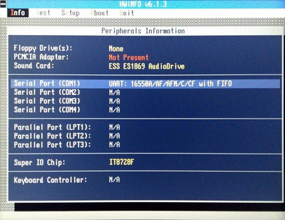

I'm not at that PC now... Mumak wrote me that HWINFO use PnP detection mechanism when supported, if I remember well the ES1869 was listed in ISA/PNP section so it was detected by PnP not direct access.
UPDATE: I just inspected PCB soldering under stereoscope magnifier and didn't find anything suspicious. Also I checked ISA bus and fintek bridge pinouts and wiring-should be ok. I use config with default IO address, disabled ROM decoding and disabled kbd/mouse.

1st I got an idea to test with my POST card. So I setup single IO window for 80h:
C:\DOS\DRIVERS>sapphisa.exe 80 0f
Found Intel LPC Controller.
Found Fintek F85226FG LPC-ISA Bridge
Enabling Range 0 : Base 80, Mask f, LPC f0081
Ports : 80-8F
and send some data there:
smb /dbg
CMD:> outportb(80, aa)
AAh -> port[0080h]
CMD:> outportb(80, bb)
BBh -> port[0080h]
and yeah, the display light up, so it seems at least address and data bus works.

Then I looked again at Unisound output and it shows some extra port CTR:660 that was not included before:
C:\DOS\DRIVERS>unisound.exe
Universal ISA PnP Sound Card Driver for DOS v0.80a. (c) JazeFox 2019-2022
PnP card found: [ESS1869] ESS ES1869 Plug and Play AudioDrive
Loading Unisound default settings...
ADD:220 OPL:388 MPU:330 IRQ:5 DMA:1/0 CTR:660 JOY:201
Initialization done.
ESS Mixer [VOL:85 WAV:80 FM:80 LIN:0 CD:0 MIC:0 3D:0]
So I included it to IO windows (a bit confused how base and mask actually works for a range but should be OK for now):
C:\DOS\DRIVERS>sapphisa.exe 200 fc 300 70 388 1c 660 3f

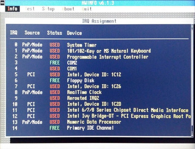

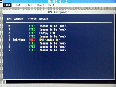

Then important change happened - ESSCFG found and initialized the soundcard 😀
But now I'm facing probably some IRQ problem. I tried both options 5 and 7 but none works. SBPRO Test programs cannot find IRQ and Doom SFX is silent. But now I got at least the FM and MIDI music. Also Boost demo by Doomsday (uses MIDAS) no sound. But MPXplay plays MP3 file fine. I think MPXplay may not use IRQ/DMA? It shows snd as SBPro.
For this test I disabled LPT port to save IRQ 5/7 but according to HWinfo it seems some other PCI devices is occupying it and I cannot get rid of them. The SETUP don't have common PCI&PNP section that allowed to reserve some IRQ for legacy, no way 🙁

Hmmm... system devices taking up IRQ 5 and 7? From what I searched... 1C12 is a root port and 1C26 is a USB controller.
You're unlikely to find options to reserve IRQ for legacy on such new boards... Maybe you can just leave printer port on either 5 and 7 and put your card there. Back then LPT ports appear to permit its IRQ shared by sound cards, since both had a default IRQ of 7. Letting the printer port taking up that IRQ might at least block PCI/PCIe devices from taking it.
By the way... from your test result, looks like the A00 address range is only needed during PnP setup and most likely not needed anymore once configured, and it can then be assigned for a different purpose until you need to configure it again.

Good point. When I reenabled LPT1 with IRQ7, it kicked PCI device off. Then I configured ESSCFG with IRQ7 and modified BLASTER env. I hope it could be shared as I wouldn't use any LPT communication during gaming. SBPro test still cannot find the IRQ but Doom catches on and I got SFX! 😀 But Boost demo couldn't find it and still silent. I don't know if possible to force it to IRQ7, probably no cmdline args, MIDAS should have some autodetection. It could also affect other programs using MIDAS. Need more testing...
I don't know what port A00 was for but yes, not needed at least for ESS. I think ESSCFG tries communicate at 660h. Maybe only needed for init. I could try to remove this window after ESSCFG if it still keeps working...

If Boost demo expects IRQ5 you may consider assigning LPT1 to 278h/IRQ5 to see if it makes a difference.
Also, make sure you configured BLASTER environment variable correctly. Note that UNISOUND also uses BLASTER to configure the sound card, and it accepts some new parameters for configuring extra features. You can refer to UNISOUND's manual for details.
Sound card detection mechanisms may or may not work for a variety of reasons, but if the game detects the sound card and plays fine then it's okay. In my current systems SETD (from DIGPAK) never succeeded in detecting my Sound Blaster PnP cards (including a Sound Blaster 16 PnP) but audio worked fine when I manually set the driver up.
