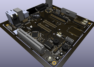

Reply 158 of 474, by Eivind
I started working on the conversion from PCI to AGP today, and ordered a bunch of AGP connectors though JLC. They were over 11 times as expensive as the PCI ones, guess not that many people are using AGP these days huh...
The LlamaBlaster sound card
ITX-Llama motherboard
TinyLlama SBC
Reply 159 of 474, by Eivind
Update:
I've re-routed the board to accommodate an AGP slot. Aside from a couple of minor tweaks here and there, the other main difference was going back to using the SD card's signals as the source of hdd activity for the LED and clicker. My previous attempt of letting the BIOS tell the MCU when to click worked great in DOS (which uses BIOS routines for communicating with the hard drive), but not at all in Windows 98 which bypasses the BIOS for such things.
Waiting for the batch of AGP connectors to reach JLC before ordering the fourth prototype...
