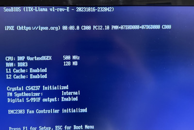

Reply 238 of 475, by Eivind
@doogie: I compiled iPXE for the RDC 6040 and built a new BIOS with the romfile included, got this:
1.04 MiB
1300 views
...so I guess that's promising? 😀
I'm a total noob when it comes to PXE though, haven't touched that stuff in like 20 years. If you've got a (simple) way to test some more using a raspberry pi as a pxe server, I'd be happy to give it a spin!
