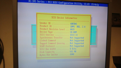

So, I got that Tekram SCSI controller working, and tested the strange SCSI card! It doesn't reveal anything new, but I can share what it looks like in the SCSI configuration.
I guess the new thing is that it mentions "CD-ROM", but perhaps that's just what it was best for them to have it behave like, if it was running some detector which would of course only provide data but not be anything that can be written back to.

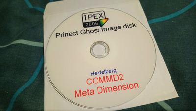

But speaking of that, I did come across a CD(-R) in all this stuff which mentioned "Heidelberg". No idea how relevant it is however, and it just contains a "GHS" and a "GHO" file, which are apparently drive backups or something. So, this doesn't answer any questions, and may only ask more haha.

teh_Foxx0rz wrote on 2023-11-06, 22:26:
But yeah, I think that's as far as I can get with what I already have, at least.
The drive report sounds like a SSD that behaves and contains an image of a CDROM.
You need Norton Ghost (classic) to open GHS files. I don't know whether 7zip can handle them too.
