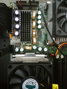

Reply 27 of 38, by Irinikus
TheOkMan wrote on 2023-07-17, 17:08:
I have a Supermicro P4DCE+ with the newest bios it works with the 3ghz gallatin's. I put heatsinks on the vrm to keep it cool works great
Thanks very much for the info! 😀
Can you maybe post a pic of your board showing your heatsink solution?
YouTube
Reply 28 of 38, by TheOkMan
I put some 20x20 aluminum heat sinks and a small fan. It's the heat sinks with the thermal tape it's not the best solution but it works
603.44 KiB
901 views
Reply 29 of 38, by Irinikus
TheOkMan wrote on 2023-07-17, 17:48:
Thanks very much for the input!!! It's highly appreciated! 😀

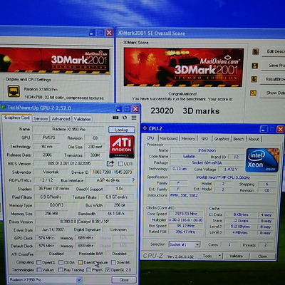

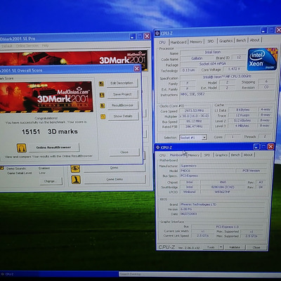

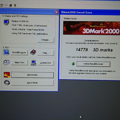

Reply 35 of 38, by TheOkMan
I tested the ATI Radeon x1950 pro agp on the gallatin's
475.92 KiB
751 views
529.66 KiB
751 views
Reply 36 of 38, by Irinikus
TheOkMan wrote on 2023-07-19, 05:01:
I tested the ATI Radeon x1950 pro agp on the gallatin's 20230719_005941.jpg20230719_004406.jpg
Which motherboard were you using for this test?
YouTube
Reply 38 of 38, by Irinikus
TheOkMan wrote on 2023-07-19, 15:42:
Supermicro P4DCE+ with 2gb of 800 40 rdram and a Radeon x1950 pro agp
Cool! That's a pretty good score! 😀
